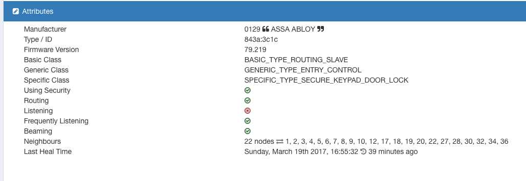

Hi Chris, awesome work. I had some time to play around this weekend with this. I have 2 locks, a Kwikset deadbolt and a Yale lever lock (YRL220). The Kwikset paired easily with lock, alarm and battery channels working nicely.
The yale lock has proven to be more difficult. The first issue was the device and type ids were not in the database, this is usually not a problem, but more on that latter. After adding the new ids to the existing yale xml file, things looked ok, habmin showed all green statuses for my thing, but the channels were not working (lock, alarm, battery) nor were any neighbors being reported.
I went ahead and excluded it and attempted to re-add it. The deviceId and deviceType changed! (the manufacturer id is the same) Not sure how that’s possible. I had prematurely uploaded the first attempt’s xml file to your website for the Yale lock, I think you should ignore that for now :slight_smile: Below is a screen shot of habmin, eventually I did get neighbors reported. I saved the logs from inclusion if you want me to post to your site. Let me know how I can help!
