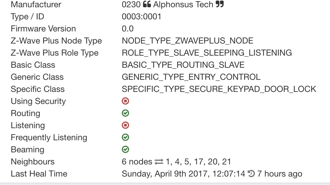

However I am not able to control it. When I command it to switch the lock it gives me the following entries in the log:
2017-04-09 17:33:04.838 [WARN ] [nal.converter.ZWaveDoorLockConverter] - NODE 19: Command class COMMAND_CLASS_DOOR_LOCK not found
2017-04-09 17:33:04.841 [ItemCommandEvent          ] - Item 'Lock_IdLock' received command OFF
2017-04-09 17:33:04.848 [ItemStateChangedEvent     ] - Lock_IdLock changed from ON to OFF
Nothing happens on the lock end at all.
This probably means the binding thinks secure inclusion did not happen, see OH2 Z-Wave refactoring and testing... and SECURITY - #488 by chris
Did you get a message in habmin that secure inclusion was successful?
You are right Olav. Inclusion must have gone wrong somehow. Seems Using security is marked no (and same error when trying to control it).
Excluded it and did a new inclusion with the network set to use security for all types of devices. Got a new NodeID (22), but still did not mark Using security:
There is another thread with ppl also having trouble with this for the idlock. I did an exclude, removed all the batteries, and then included again with the controller close (20cm or so). That did the trick for me.
I`ll give it a try it. Extremely impractical to move the device close to the controller. The lock sure cannot be moved, but I will get a long network cable and keep it close.

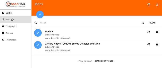

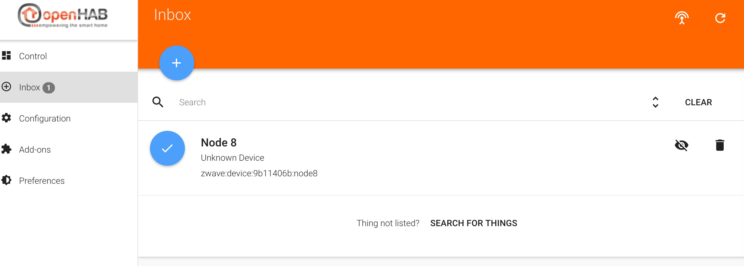

Not certain if this has been mentioned before in this thread. But, when a new thing is discovered it is displayed as unknown until I add another thing. Then the first thing is being shown with it´s complete name and properties. Is this something wrong with transactions?
Before adding my next devices it would stay like this for at least 20 minutes (as long as I have waited when reinstalling all my devices):
After adding another device to the network (same time as new device is discovered):
