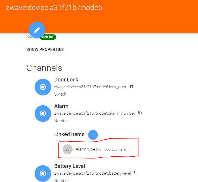

It’s good to see that the binding is receiving the alarm messages. But, it’s not passing them through as a Number to openHAB. This event in the DEBUG log was captured immediately after I manually locked the deadbolt (thumb turn).
Below is a screenshot of the item that’s not receiving ANY update whatsoever. It remains “null” no matter what happens to the door. frontDoorLock_alarm is a “number” item, defined through the paperUI.
I’m happy to provide any information necessary to help figure out what’s going on. Just let me know!
