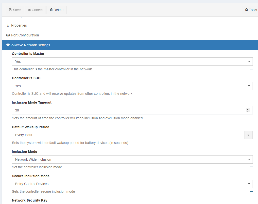

Hoping there is help out there, I cant seem to get my Yale lock to work, this is starting with the Yale lock factory settings, and I keep the lock on, by pressing the screen the whole time during inclusion and while I set it up in the paperui.
Best example of an error, as nothing seems to work, when I turn the lock manually I get this in my logs:

Here is some of the inclusion logs, i think:

Is security enabled in the controller settings?
In habmin under security it has a question mark. I don’t know where else to look, I don’t see any other mentions of security under this thing.
No I do not.
I see a green checkmark.
This is in the database and other people are using it successfully.
You have two zwave bindings installed. They both have security, but probably best to clean that up. If you only have the one jar in addons, an OH restart should fix it. Ghost bindings can be a pain to get rid of sometimes. When updating the binding, keep the name the same and overwrite the old one. I always shut OH down before updating too.
Select the controller, select Tools (top right)> Advanced, then look under Zwave Network Settings> Secure Inclusion Mode. You probably should chose Entry Control Devices, if you are only using a lock. [Nevermind… if it’s securely included then this is not an issue]
This is a good sign. The lock should be securely included and may still be initializing. Depending on the number of devices, this can take a while.
When I click on tools, after selecting advanced options I only have 4 choices:
Soft Reset Controller
Hard Reset Controller
Exclude Devices
Synchronize Network
Thanks allot for your help so far, really appreciated.
So if my settings, once advanced is selected, are like you describe then it means it might just need more time before it might work?
You are very welcome!
If you have a green checkmark next to security, then you’re securely paired, so security is enabled. I don’t know if having the two bindings installed could cause any problems though, so I’d shutdown OH, check to make sure only one jar is in addons, and then restart OH and check that only the one shows up. Then wait .
