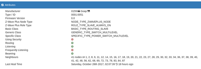

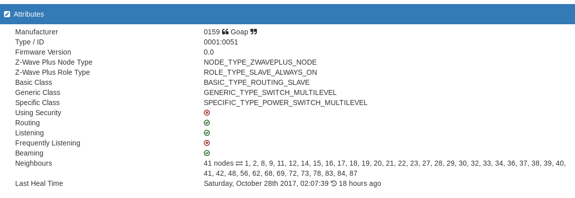

@chris I was following the Qubino status thread, and was looking around when I found something that I consider rather strange; on one of my Qubinos, I have a node neighbour list that simply cannot be true - it is listing a device that has not been around for about 18 months - node 2. Node two is probably still on the stick though (Aeon Gen5), since I have not been successful in removing it. I know there’s a generic zwave tool that is supposedly able to remove ghost nodes, but I haven’t got around finding it. Node two are currently in the “inbox” after I have tried to add it and delete it about a month ago. Also node two was long gone when I added this Qubino, so I guess this is the stick doing bad stuff?
It also says that it was healed last night - shouldn’t the heal deal with these kind of issues?

The heal won’t remove any devices - it’s not in the business of deciding that a node is removed from the network and then deleting it. If the neighbours shows a node in the list, then chances are the controller said that the node was a neighbour. The binding doesn’t do any processing of this information - it simply displays the information from the controller. If you have a debug log showing the heal I can take a look, but I would be surprised if this isn’t the case.

I understand the binding cannot remove a node, but to me this is a controller bug - adding a node that has been long gone to a new-ish node. But I guess it could also be (more likely) that the new-ish node wrongly got the assumption that a broken message came from a ‘node 2’, and putting it into its neighbour list. Perhaps this is a problem with the zwave protocol - I think I read some time ago, that it has a very simple checksum on the messages.
Maybe - I don’t know without more information (ie the logs) to see what happened. I agree it doesn’t look right, but in any case I doubt I can do much about it.
I don’t think it’s “very simple”. Maybe you are thinking about the messages over the serial API (between the PC and the stick) which do use a simple checksum since it’s a reasonably reliable serial/USB link. The radio packets use something a bit better than this.
