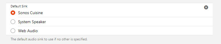

The Audio settings is well defined:in the settings:
Here is the error description: I also have an issue with my Sonos / Symfonisk setup. It used to work a while ago with some 2.x version of Openhab. I can scan for SONOS boxes, my Symfonisk gets discovered and is shown as ONLINE. I can also select it as the default audio sink in the settings on the web UI:
However, it is not shown when running openhab:audio sinks, my SONOS box is missing:
* System Speaker (enhancedjavasound)
Web Audio (webaudio)
Any ideas?
Since I wasn’t using it frequently, I don’t know when it stopped working. For sure it did not work using any of the 3.x versions. I’m running Openhab in Docker with the current milestone version (3.1.0.M1).
