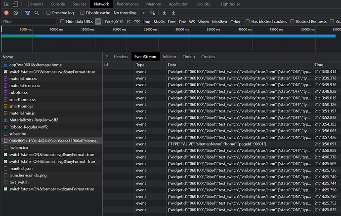

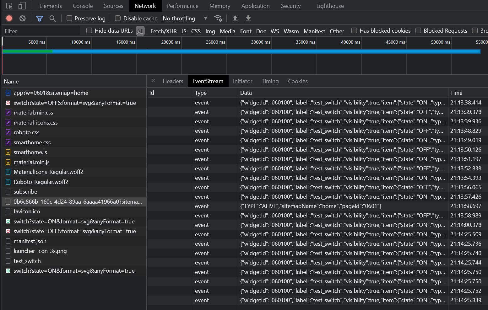

Not sure if this helps at all, but I did reinstall the rrd4j persistence and did another test where I watched the network traffic of the website. I was actually curious whether after that timeframe all of the “lost” events were actually transmitted or whether they were actually lost.
As you can see before the full minute it is swichting back and forth. Then after the timeframe elapsed a couple of messages are being sent at once, but not with alternate states as I would have expected but only multiple ones of the current state ON (most likely that fits to how often I toggled). When the current state was OFF it’s the other way around.
That looks like a queue of “send the state” tasks built up. Then when the queue is released, all the tasks send the current state (which is a reasonable thing to do, for this UI purpose). Maybe the underlying issue is more like persistence putting a lock on the Item; competing for access to Item rather than system resource.
