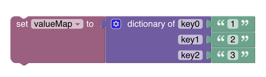

  1. In the list category there is a block to define a dictionary (what should result technically into a map if I understand correct), but I’m missing any block to read / get a record from the map or update the map. As this is some general non OH related stuff I googled it and a “get key” block should exist, but I cannot find it in my openhab instance.

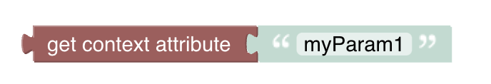

regarding 1)

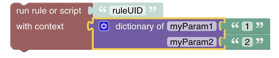

This is kind of true. The dictionary was introduced by us (it is.a OH block) to allow passing parameters to other rules via a map. I only very late (but soon enough) noticed that there was a block missing that would be able to pick it up on the receiver rule side. So this is part of the release.
and then retrieving it via
However I guess what you are trying to do is
but there is no way of accessing this they keys from there. At least for the time being. Implementing such a block though is not a big deal and could be part of a next milestone release.
If this is not what you are looking for please be more specific what you expect.

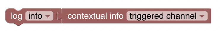

This should be the block you are looking for
see here and Event Object Attributesfor more details.
which generates the following code
logger.info(event.channel);

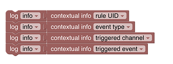

I have created the following rule that is triggered by a Nanoleaf swipe and it reveals what you requir
logger.info(ctx.ruleUID);
logger.info(event.type);
logger.info(event.event);  // not available in blockly
[org.openhab.rule.testECMAChannelEvent] - testECMAChannelEvent
[org.openhab.rule.testECMAChannelEvent] - ChannelTriggeredEvent
[org.openhab.rule.testECMAChannelEvent] - nanoleaf:controller:4D2D1FEC7F78:swipe
[org.openhab.rule.testECMAChannelEvent] - LEFT
Here is your Xmas gift: Adding it was pretty easy: here it is already in my environment. It will be released latest with 3.2. M1

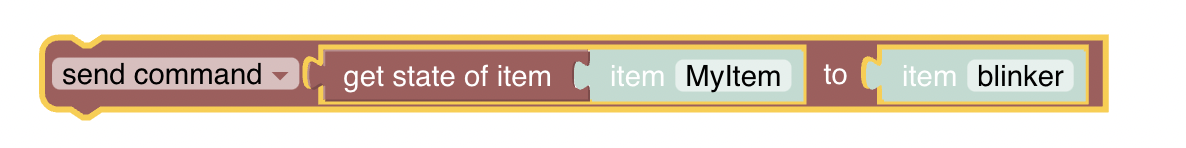

Regarding the copy state block: could you just do the following (though yours looks more elegant) ?

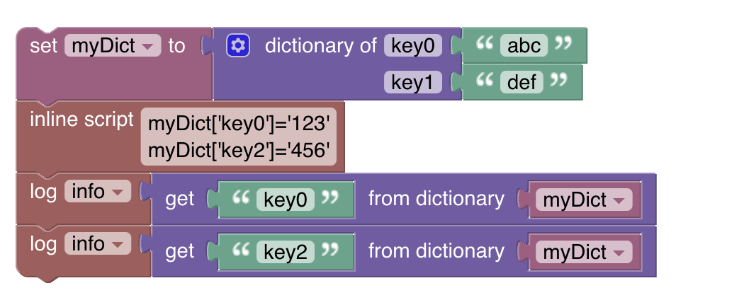

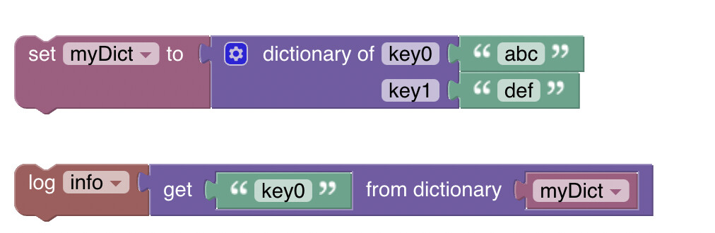

Here’s another gift for you which is already which I intend to deliver with 3.2.M1:
What do you think about the inline-Script block? :wink:
which would the result into the following code altogether:
myDict = {'key0': 'abc', 'key1': 'def'};
myDict['key0']='123'
myDict['key2']='456'
logger.info(myDict['key0']);
logger.info(myDict['key2']);
The inline script and the additional dictionary blocks look great! Thanks a lot for this.
Regarding the copy:
Yes, your “send command(get state of item, item)” is technically exactly the same. My only intention was to make the blocks more easy to read (maybe it will help some beginners who are not so familiar with scripting).

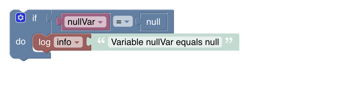

I there any example how to check for the initial value == NULL?
I tried the following, but none works:
you can do it like the following
which creates the following code
if (nullVar == null) {
  logger.info('Variable nullVar equals null');
Thank you, Stefan. :slight_smile:

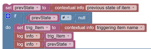

Unfortunately this does not work either:
during startup when my last received Telegram command is restored from persistence (from NULL) this leads to:
2022-06-14 06:32:27.839 [INFO ] [org.openhab.rule.TelegramCommando   ] - TelegramBotHomerBot_LastMessageText
2022-06-14 06:32:27.897 [INFO ] [org.openhab.rule.TelegramCommando   ] - NULL
  • Can you log out the prevState variable and show the log output?
  • Can you please paste the generated code here?
