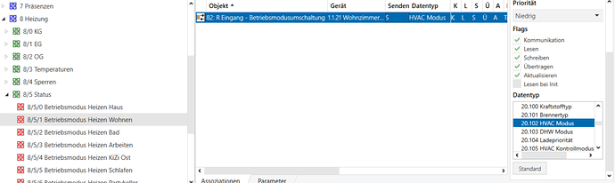

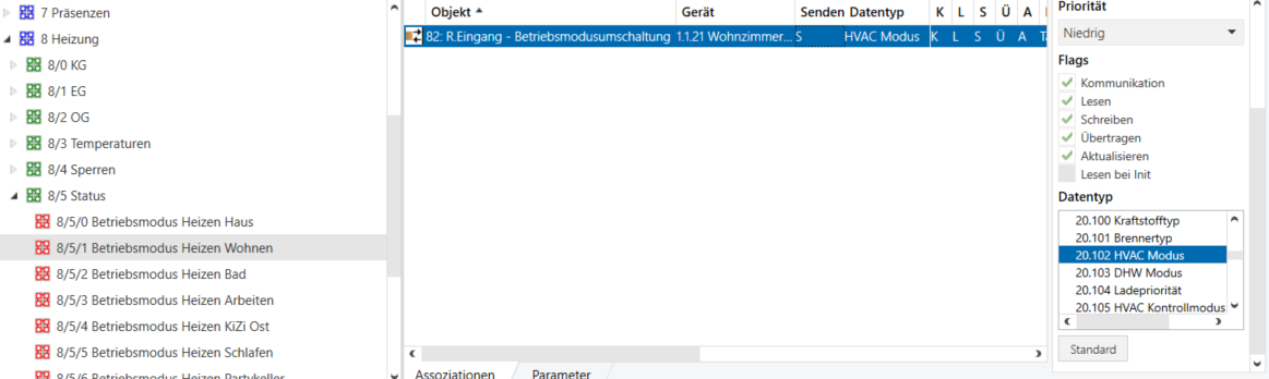

So, there’s the GA 8/5/1 for living room with a 20.102 HVAC Mode for setting the mode (works fine with the sensor and does, what it should)

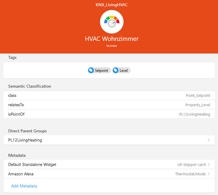

I added the HVAC-item as follows:
