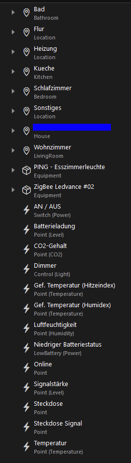

The Locations “Bad”, “Flur”, “Heizung”, “Kueche”, “Schlafzimmer”, “Wohnzimmer” are completely wrong.
For example, I am also missing the second floor and the first floor as a whole.
However, all items are still present.
The new creation of missing locations does not work, because they are supposed to already exist.

The subdivision per floor is completely gone.
The living room on the second floor is gone.
The groups of Things it contains are also gone.
By gone / no longer present I mean invisible, because the Things are still all present in the system.
All other “rooms” have been pushed to the top branch of the tree.
What seems to be still correctly present are the assignments to “Other” and everything at “Outside”.
