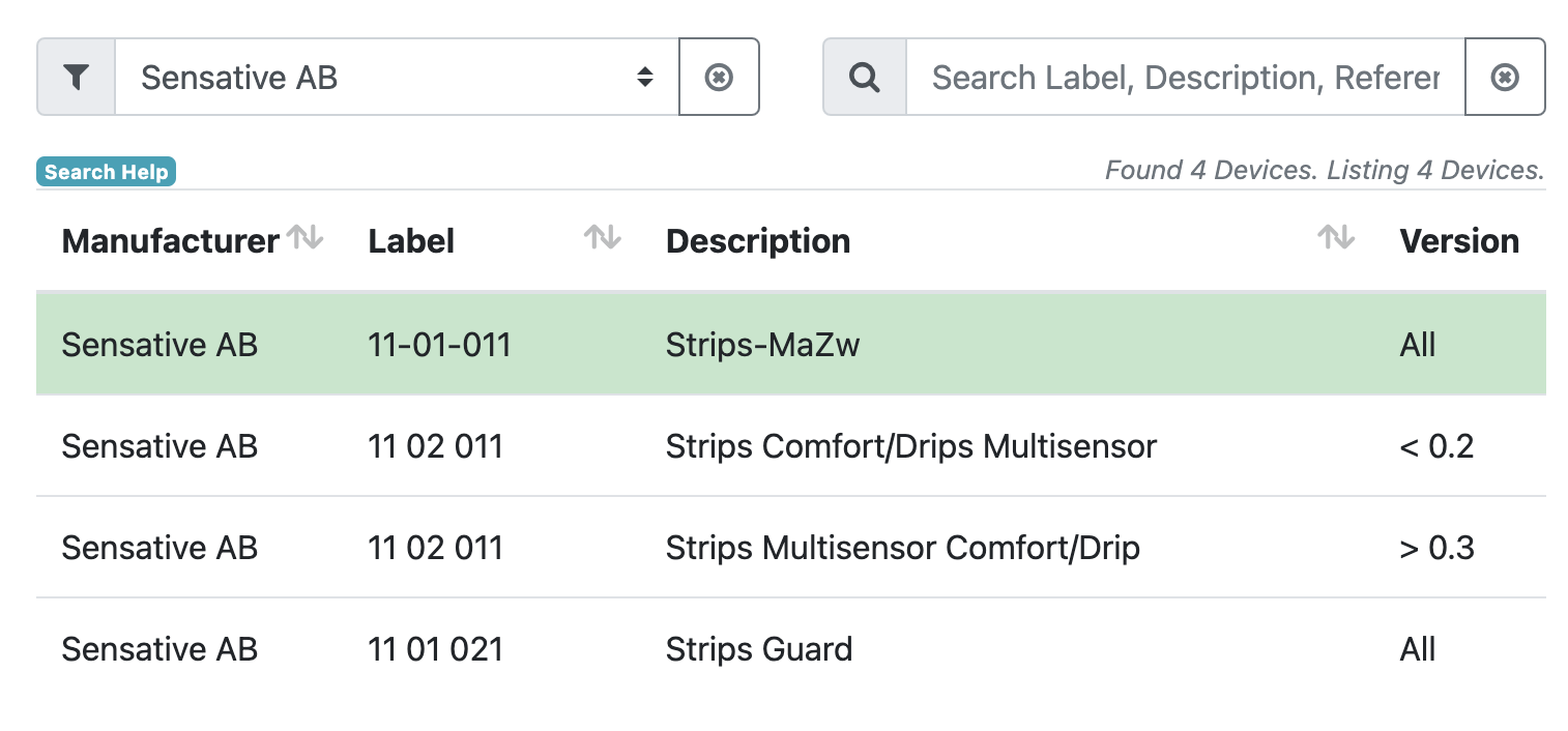

I recently installed OH3.3 on CentOS. I have a ZWave Serial USB controller running at /dev/ttyACM0 and I have one EcoLink door sensor working just fine. However, I am trying to add what appears to be a newer Sensative AB Strip - 11 01 022 - than what is in the database.
How does one get this device added to the database or is there an option to copy 11-01-021 that I simply haven’t run across yet in the documentation?
Thanks in advance.
If you look them up in the zwave database you can see that they have not been added there
So, you need to add the before they can be used in openHAB.
see the DB-Guide on how to do that.
