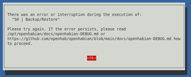

  • and get this error:
  • after hitting OK I got the menu… and exited out.

Update:
I set the /etc/openhabian.conf to debug=maximum.
… going through the 1,000 lines it created in the terminal, I see:
$ chown --recursive backup:backup /media/SynologyBackup
+ chown --recursive backup:backup /media/SynologyBackup
chown: changing ownership of '/media/SynologyBackup/20221119-0800_backup.tar.gz': Operation not permitted
chown: changing ownership of '/media/SynologyBackup': Operation not permitted
+ return 1
+ echo 'FAILED (chown)'
FAILED (chown)
+ return 1
+ return 1
+ '[' 1 -ne 0 ']'
+ whiptail --msgbox 'There was an error or interruption during the execution of:\n  "50 | Backup/Restore"\n\nPlease try again. If the error persists, please read /opt/openhabian/docs/openhabian-DEBUG.md or https://github.com/openhab/openhabian/blob/main/docs/openhabian-DEBUG.md how to proceed.' 14 80
So, it could not change the owner on the NAS; fair enough.

Just wanted to add, since this post was the only thing giving me the right hint:
in /var/log/amanda/openhab-dir/amdump*
up: 0 driver-idle: no-dumpers
driver: interface-state time 1061.549 if default: free 83708
driver: hdisk-state time 1061.549
driver: result time 1061.550 from taper0: PARTIAL worker0-0 00-00004 INPUT-GOOD TAPE-CONFIG "3ad83486:14306344960" "[sec 1048.000000 bytes 14306344960 kps 13331.145038]" "" "10 tapes filled; runtapes=10 does not allow additional tapes"
driver: finished-cmd time 1061.550 taper taper0 worker worker0-0 wrote ohpx:/dev/mmcblk1
dumper: kill index command
this in turn created the state read: recv error: shm_ring is cancelled error.
So in my case I had runtapes 10 and length 1365 mbytes in my define tapetype in my config file (/etc/amanda/openhab-dir/amanda.conf)
Going to runtapes 20 solved it for me.
Thanks !
