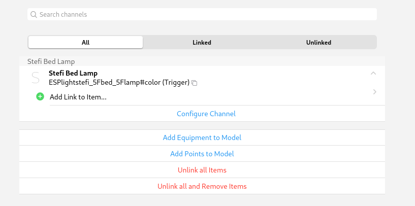

Perhaps confirmed by the UI ![]()
UID: mqtt:homeassistant_98f4abcd5b2f:Localhost:98f4abcd5b2f
label: Night Lamp Stefi
thingTypeUID: mqtt:homeassistant_98f4abcd5b2f
configuration:
topics:
- light/night-lamp-stefi/stefi_bed_lamp
basetopic: homeassistant
bridgeUID: mqtt:systemBroker:Localhost
Still, the only channel available does not seem to control the light
