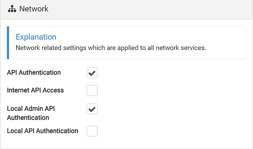

What do your hyperion logs say? Increase the log level there too. What are your settings under Network Services? For example did you turn on Local API Authentication? (mine isn’t)

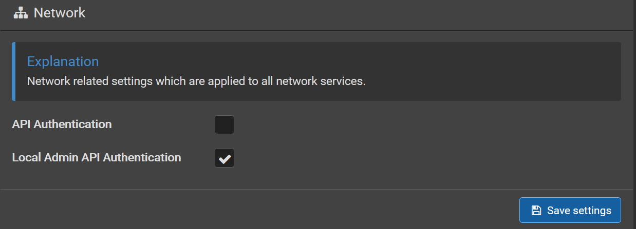

Networksettings of hyperion are all set to no authentication, only the admin password is active at the moment
That is not an answer to my question. What are your settings? Mine are

Sorry, I though I answered it, as only the admin password is active:
But seeing your screenshot I also tried to activate API Authentication… and guess what.. now it works, but I don’t get why :roll_eyes:
