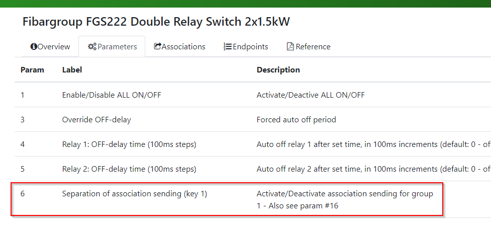

I did not study the manual, bit check Parameter 6.
I have view this and there isn’t Parameter 6.

From our database entry for the FGS222 here.
