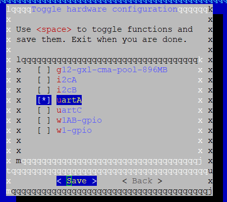

My problem is that RX/TX isn’t working (pin8 and 10):
in armbian-config I switched on a uartA:
but what is device name ? I tried ttyS1 and also ttyAML1 but not working
What’s wrong ?

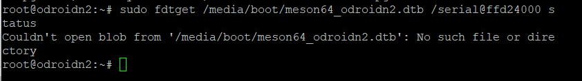

Have a look here https://forum.odroid.com/viewtopic.php?t=37019 the path /meda/boot/… seems to be wrong.

Have you seen my previous post
yes, same error as before

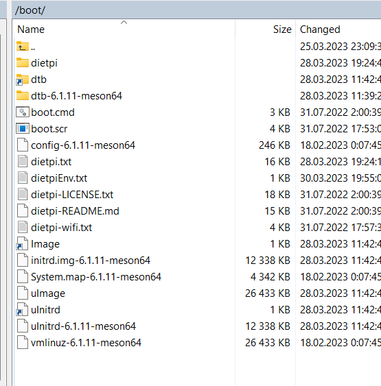

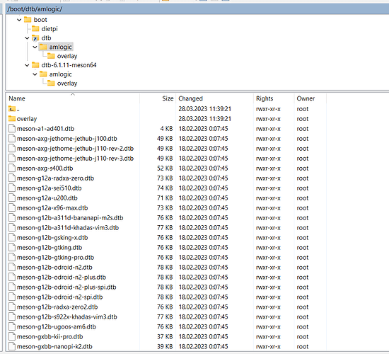

What is content of the /boot directory ?
this for dietpi which I have running now, but armbian has nearly the same

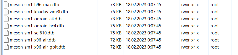

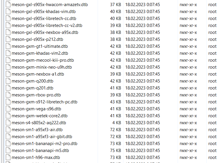

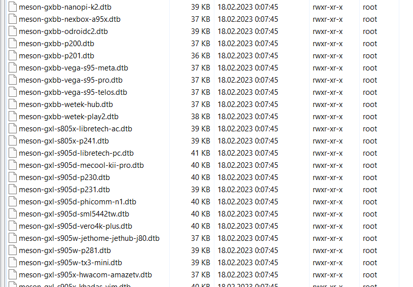

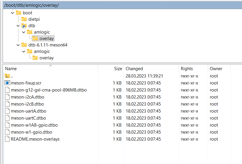

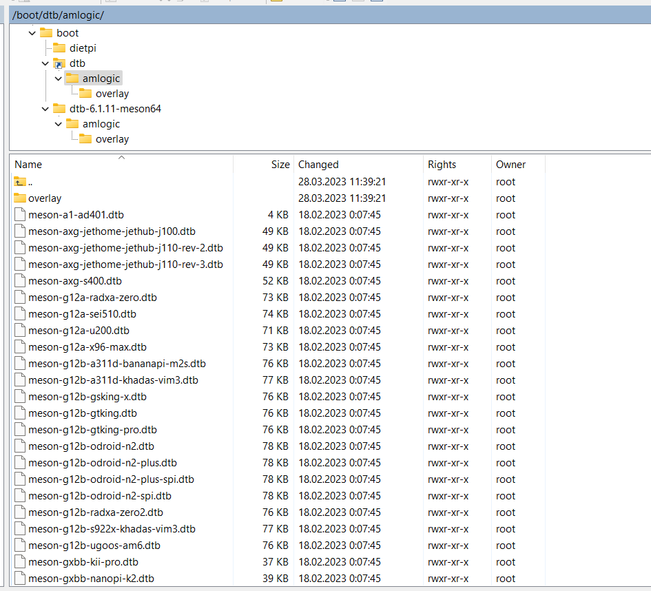

What is the content of the two dtb directories?
directory overlay:
content of the “dtb” and “dtb-6.1.11-meson64” is the same
