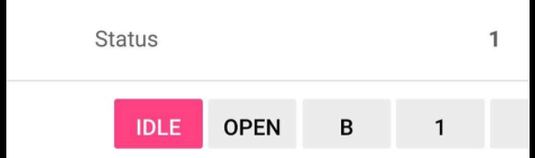

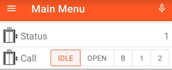

The Switch button minimum size has greatly increased since OH2.5, and so the items I need for minimum functionality no longer fits on my phone screen.
Here’s how it was represented in OH2.5:
..and here’s how the same item is represented in OH3:
I tried changing the first two buttons to a single character label but the size stayed the same anyway.
I would like the buttons to be smaller, the way they were in OH2, so that they fit on my screen. :slight_smile:

If I’m not mistaken the first screenshot is taken from the android app displaying the sitemap while the second one is from a browser.
I do see the same when displaying the sitemap via browser, however when displaying it via the app the switches are displayed as a dropdown selection.
Oops. I didn’t think of that. You are correct. However, I’m not looking for a dropdown selection, I do need direct buttons. Do you mean the openHAB app will display 3.2.0 like it displays 2.5.0?

I just installed the app on a different android device, pointed it to 3.2.0 final, and it displays like before! Switch is displayed as discrete buttons and the single letter label buttons are smaller than the longer label buttons.
So, it works fine, always has – the only was me, I was indeed comparing the web browser to the app. My bad.
