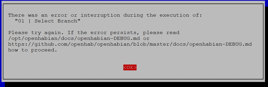

This is what happens when selecting option 01:
and below my output.txt:
output.txt (38.5 KB)
Do I need to undo the changes you proposed earlier first ?
save this code as /opt/openhabian/functions/openhabian.bash and
this as /opt/openhabian/openhabian.conf.dist to your machine.
Do not let openhabian-config update itself on start (that would overwrite them).
Take a copy of your /etc/openhabian.conf then try again what you did last time to produce the eror.
There’s a problem with your ‘patching’: openhabian.bash is broken or does not exist that’s why it does not find the functions defined in there.
You have not set clonebranch=conftest. Do and try again please.

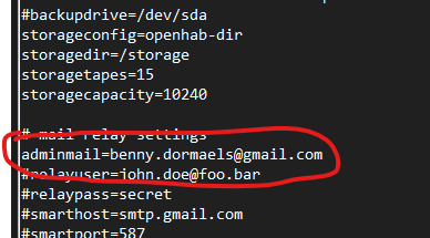

Here are the steps I did:
  • Open WinSCP (with root)
  • Modify /etc/openhabian.conf to my email address and save the file
  • You can see the modified timestamp below
    conf1
  • Open Putty and login with user Openhabian
  • script output.txt (for logging purposes)
  • sudo openhabian-conf
  • check /etc/openhabian.conf in WinSCP again, file has been updated again with John Doe

So for some reason it is modifying /etc/openhabian.conf directly after I open openhabian-conf, I don’t even select any menu in there, just open, and it looks like the “debug=maximum” is reading openhabian.conf after modifications have been done already.
Edit /opt/openhabian/openhabian.conf.dist and remove the # from the adminmail line then try again.
(You don’t need to select anything in the menu, replacement happens on startup)
When modifying the adminmail variable in /opt/openhabian/openhabian.conf.dist and NOT /etc/openhabian.conf then it is not overwritten in /opt and the e-mail is send after the backup
