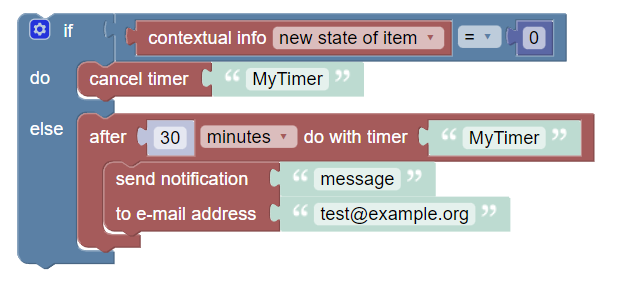

Btw: If you would do it with blockly it would look like this:
and would produce the following code that you can also use in a javascript rule created via UI (using standard openHAB notifications and not pushover):
if (typeof this.timers === 'undefined') {
  this.timers = [];
var scriptExecution = Java.type('org.openhab.core.model.script.actions.ScriptExecution');
var zdt = Java.type('java.time.ZonedDateTime');
var notifications = Java.type('org.openhab.io.openhabcloud.NotificationAction');
if (event.itemState == 0) {
  if (typeof this.timers['MyTimer'] !== 'undefined') {
    this.timers['MyTimer'].cancel();
    this.timers['MyTimer'] = undefined;
} else {
  if (typeof this.timers['MyTimer'] === 'undefined' || this.timers['MyTimer'].hasTerminated()) {
    this.timers['MyTimer'] = scriptExecution.createTimer(zdt.now().plusMinutes(30), function () {
      notifications.sendNotification('test@example.org','message');
