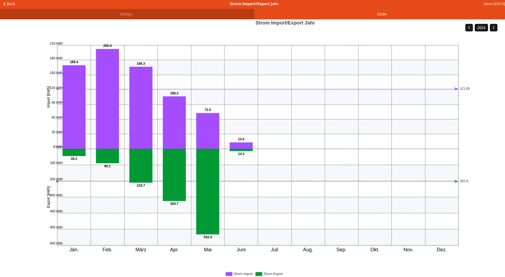

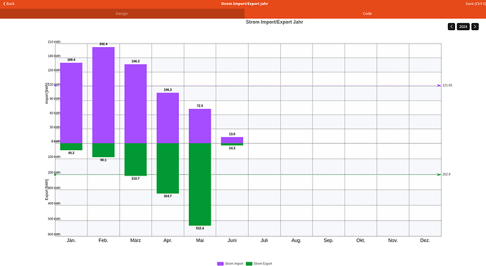

Here my implementation to show power import and export on one chart page. Both values are derived from a “counter” which is then “diff_last” aggregated for the charts.
Also note that I played a bit with formatting the bars lable (seach for formatter).

  series:
    - component: oh-aggregate-series
        item: Generic_MQTT_Thing_Smartmeter_counter_import
        gridIndex: 0
        xAxisIndex: 0
        yAxisIndex: 0
        type: bar
        dimension1: month
        aggregationFunction: diff_last
        color: rgb(166, 77, 255)
        label:
          show: true
          color: black
          position: top
          fontWeight: bold
          formatter: =v=>Number.parseFloat(v.data[1]).toFixed(1)
        markLine:
          data:
            - type: average
        item: Generic_MQTT_Thing_Smartmeter_counter_export
        gridIndex: 1
        xAxisIndex: 1
        yAxisIndex: 1
        type: bar
        dimension1: month
        color: rgb(0, 153, 51)
        label:
          show: true
          color: black
          position: bottom
          fontWeight: bold
        markLine:
          data:
            - type: average
  tooltip:
    - component: oh-chart-tooltip
        confine: true
        formatter: =v=>Number.parseFloat(v.data[1]).toFixed(2) + " kWh"
