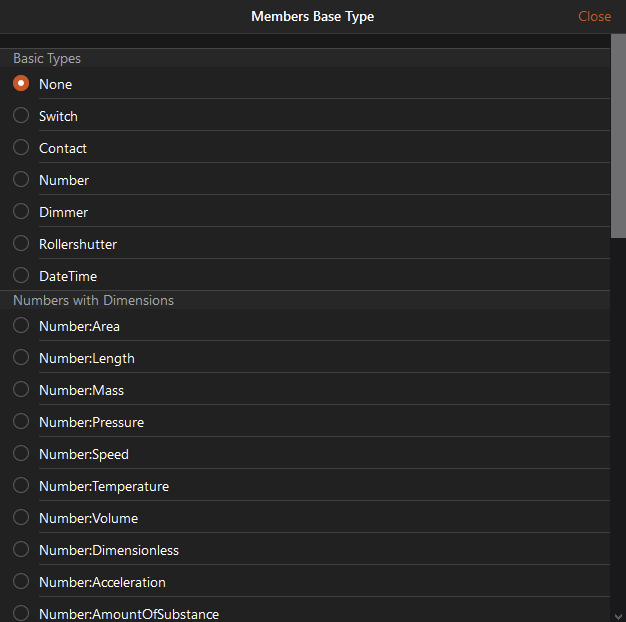

Good question. A similar one is, how to define a group of item type “Color”?
Group:Color gLightsColour “…”

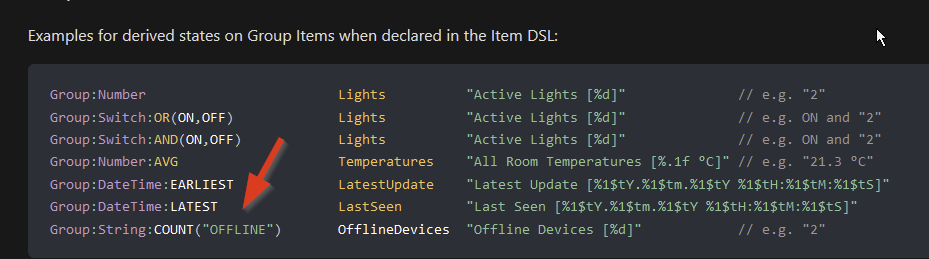

And I think several functions also can’t be defined using MainUi. According to the documentation, there should exist functions like EQUALITY, AND, OR etc.

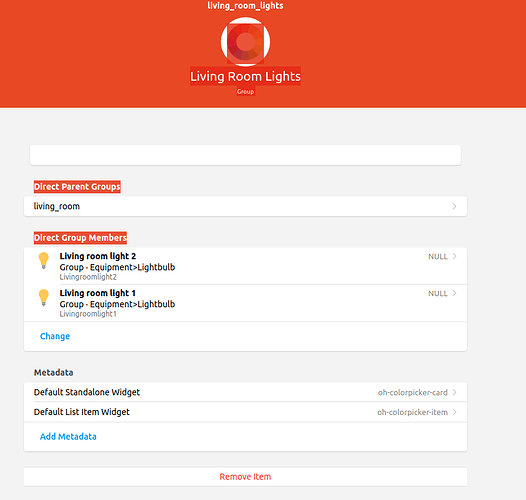

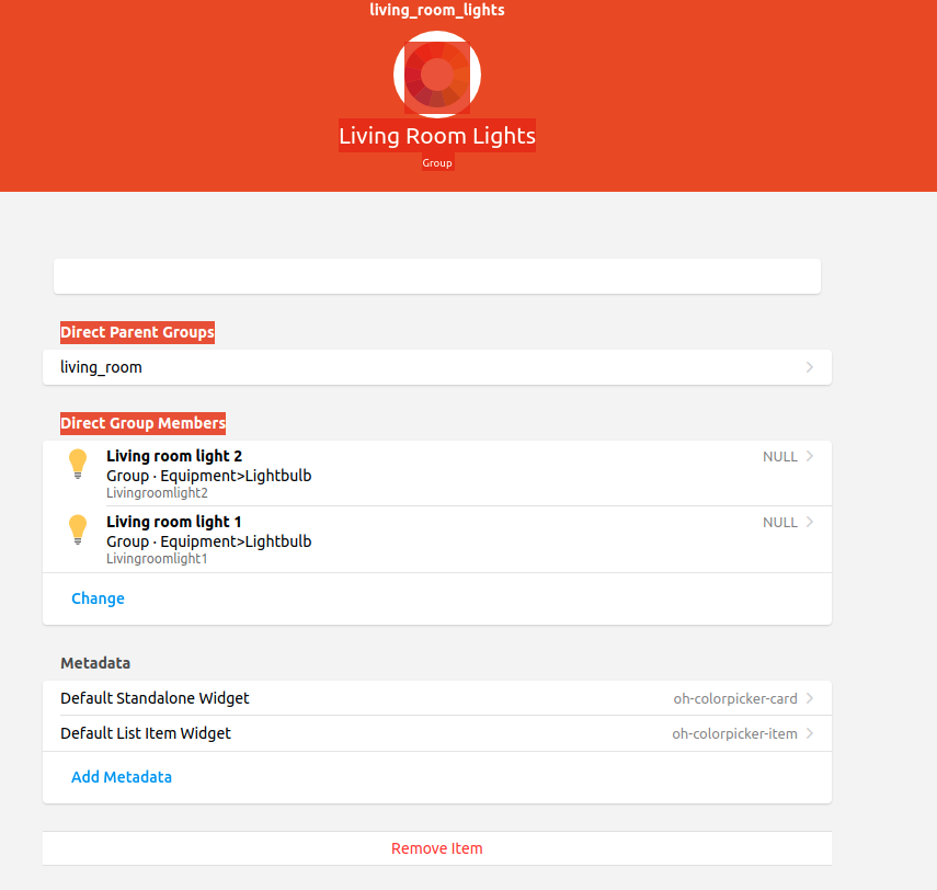

I would be happy to do any troubleshooting/testing needed in order to be able to create a group of the type “Color”.
So far, as per @rlkoshak’s suggestions, I also tried to create the group and override the standalone widget and list widget metadata to make them of the type “colorpicker”. this also does not work.
The main widget of the group ends up being a blank:
I tried the color picker with single modules and also with different combinations, and none of them worked.
Then i tried to set the group with a widget of the type slider…that worked like a charm. The lights on the group would follow the dimmer value with no issues.
