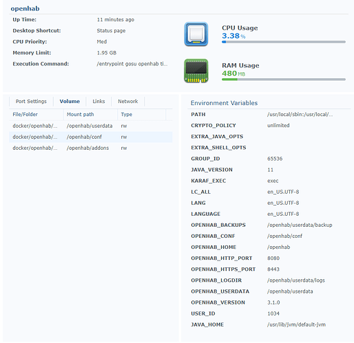

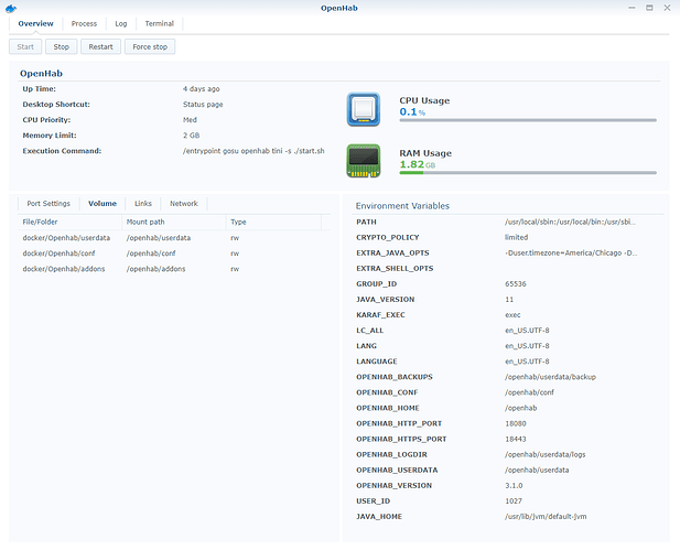

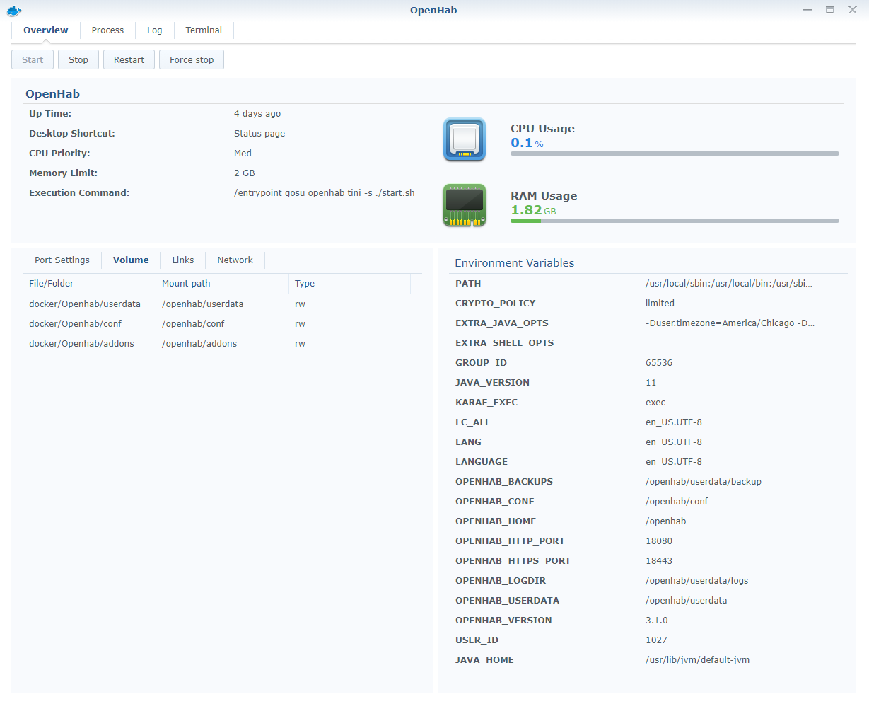

In my case I change the EXTRA_JAVA_OPTS, GROUP_ID, HTTP_PORT, HTTPS_PORT, and USER_ID environment variables. (I need to change the ports due to conflicts with other software.)

I’ve got very similar settings to you, haven’t changed the ports as I’ve got no conflicts. I set crypto to unlimited as per the docker install instructions.

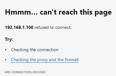

However, there always is a however, when I go to myip:8080 I get a connection refused:
I’m guessing I’ve missed something in the user rights to allow access?
