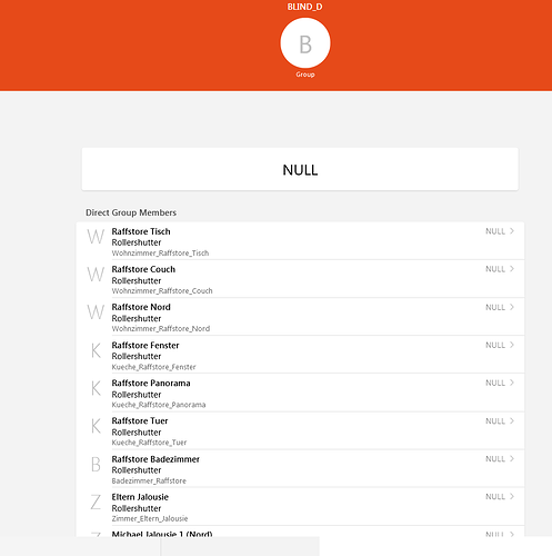

It is configured as Group inside my Items file and also “linked” to the Items (visible correctly in MainUI)
So is this kind a JS part which won’t work anymore in OH3 or am i missing something?

Well, the plain meaning of the message is that you do not have a Group type Item named BLIND_D
Having sorted out the when-section confusion, I see nothing in your rule that looks like a problem cause, and take the error at face value.
so it should work 'cause everthing is there. Checked everything multiple times before reaching out here. It also works if i set up a fresh OH2.5 with same items and rules file.
Add another log before your allMembers attempt, to make sure your Group Item is visible to the rule logInfo("test", "item " + BLIND_D.name)
Does this Group contain nested Groups? It’s possible there is a OH3 bug in allMembers if there are none, or something.
