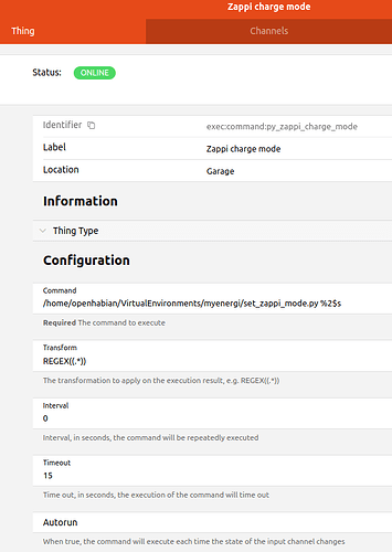

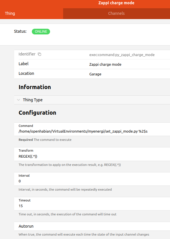

The Thing is configured as follows:
The error message I am getting is:

While I might able to gobbledegook this together, it seems all a bit much for issuing a command via a python script requiring a virtual environment.
I gave it a shot just to be stuck as usual.
[07:03:15] openhab@openhabian:/home/openhab/VirtualEnvironments$ /var/lib/openhab/.local/bin/virtualenv myenergi
created virtual environment CPython3.9.2.final.0-32 in 1589ms
  creator CPython3Posix(dest=/home/openhab/VirtualEnvironments/myenergi, clear=False, no_vcs_ignore=False, global=False)
  seeder FromAppData(download=False, pip=bundle, setuptools=bundle, wheel=bundle, via=copy, app_data_dir=/var/lib/openhab/.local/share/virtualenv)
    added seed packages: pip==23.0.1, setuptools==67.4.0, wheel==0.38.4
  activators BashActivator,CShellActivator,FishActivator,NushellActivator,PowerShellActivator,PythonActivator
[07:03:30] openhab@openhabian:/home/openhab/VirtualEnvironments$ echo $PATH
/usr/local/sbin:/usr/local/bin:/usr/sbin:/usr/bin:/sbin:/bin
[07:04:47] openhab@openhabian:/home/openhab/VirtualEnvironments/myenergi$ source bin/activate
(myenergi) [07:05:43] openhab@openhabian:/home/openhab/VirtualEnvironments/myenergi$ pip install -r requirements.txt
Looking in indexes: https://pypi.org/simple, https://www.piwheels.org/simple
Collecting ascii-graph==1.5.1
  Downloading https://www.piwheels.org/simple/ascii-graph/ascii_graph-1.5.1-py3-none-any.whl (14 kB)
Collecting daemon==1.2
  Downloading https://www.piwheels.org/simple/daemon/daemon-1.2-py3-none-any.whl (3.4 kB)
Collecting PyYAML==6.0
  Downloading https://www.piwheels.org/simple/pyyaml/PyYAML-6.0-cp39-cp39-linux_armv7l.whl (45 kB)
     ━━━━━━━━━━━━━━━━━━━━━━━━━━━━━━━━━━━━━━━━ 45.3/45.3 kB 100.9 kB/s eta 0:00:00
Collecting tabulate==0.8.9
  Downloading https://www.piwheels.org/simple/tabulate/tabulate-0.8.9-py3-none-any.whl (25 kB)
Installing collected packages: tabulate, daemon, ascii-graph, PyYAML
Successfully installed PyYAML-6.0 ascii-graph-1.5.1 daemon-1.2 tabulate-0.8.9
(myenergi) [07:07:00] openhab@openhabian:/home/openhab/VirtualEnvironments/myenergi$ ./zap.sh eco
Selected mode is eco.
Traceback (most recent call last):
  File "/home/openhab/VirtualEnvironments/myenergi/set_zappi_mode.py", line 101, in <module>
    main()
  File "/home/openhab/VirtualEnvironments/myenergi/set_zappi_mode.py", line 97, in main
    set_mode(mode)
  File "/home/openhab/VirtualEnvironments/myenergi/set_zappi_mode.py", line 50, in set_mode
    config = run_zappi.load_config()
  File "/home/openhab/VirtualEnvironments/myenergi/run_zappi.py", line 67, in load_config
    with open(os.path.expanduser(RC_FILE), 'r') as ofh:
FileNotFoundError: [Errno 2] No such file or directory: '/home/openhabian/VirtualEnvironments/myenergi/.zappirc'
(myenergi) [07:08:20] openhab@openhabian:/home/openhab/VirtualEnvironments/myenergi$ python set_zappi_mode.py eco
    main()
    set_mode(mode)
(myenergi) [07:08:37] openhab@openhabian:/home/openhab/VirtualEnvironments/myenergi$
Anyway; I think this is it.
You can always try HABApp.
It has the option to execute arbitrary python scripts in the context of the venv where HABApp was installed as a sub process.
You’ll have to run HABApp alongside openHAB but that’s never a mistake :wink: and if you’re on openhabian it’s really easy to set up (option 2B).
Looks like the file .zappirc is not available.
I am not sure if I found the right python module the description for that one tells:
A config file (~/.zappirc) is required and should contain at least the credentials used to authenticate against the MyEnergi severs,
username: <serial number of Hub>
password: <Password as used in App>
That sounds like the file needs to e created manually but it wasn’t …
So once that is fixed you may need to do at least one further trial :crossed_fingers:
Thanks :slight_smile:
Post 4 shows the file is present.
I have given up on this; too much of a hassle.
I started another post offering a bounty to fix the Zappi binding, which as it turns out is in progress. :slight_smile:
Would you be willing to try it with HABApp? It should be straight forward and easy and if you need help you can just ask. That way you could use it now and you’d learn about the best python rule engine for openHAB which is also a plus.
