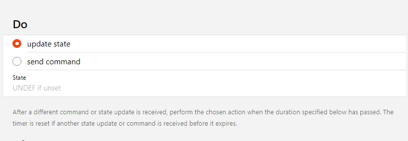

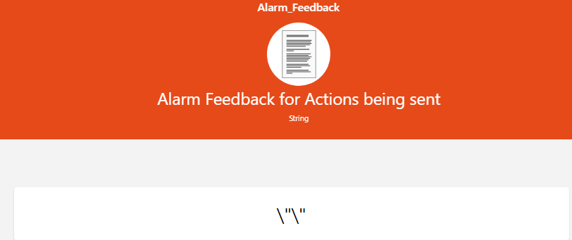

I suppose it’s doing its own escaping. And of course if you literally have the input field empty you get the default UNDEF I suppose?
Distinguishing empty string from real null is always a pain.
Circumvent by expiring to"BANANAS" or “idle” or something, and adjust your rules?

A thought though - you might find you can directly edit the Item’s expire metadata for the empty string “”

I realise this has become an interesting trail to follow now … but did you try directly editing Item’s expire metadata with empty string “” (not blank)? Set up an expire for “-” or whatever from UI, then you have a pattern to edit.
