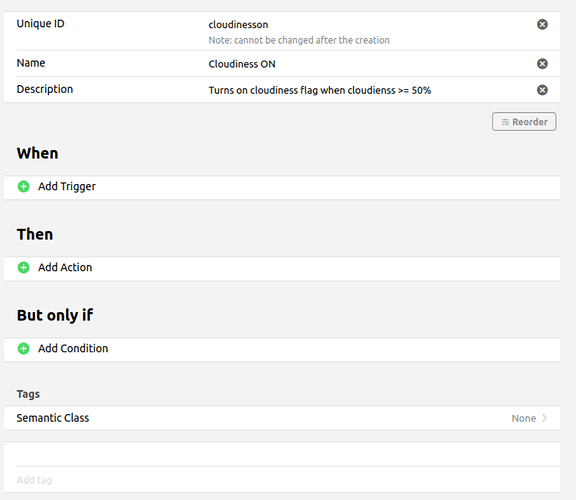

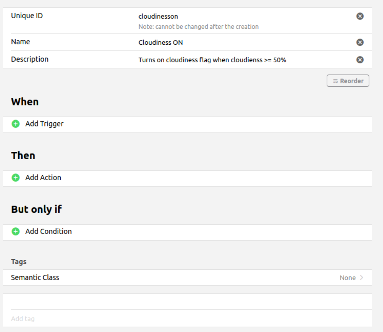

Rules are, as they always have been, event based. In MainUI a rule has three main sections:
  • when: the events that occur to trigger the rule to run
  • conditions (labeled “but only if”): the states to check to determine whether or not to run the rule
  • actions: what to do when the rule runs
So, if you want to send an ON command to Item Foo when Item Bar changes but only if Item Baz is ON:
  • create a trigger under “when” for changes to Item Bar
  • create a “send a command” action under “then” to command Foo to ON
  • create an “a item is a given state” condition under “but only if” and configure it with Baz == ON
For both the conditions and the actions you have an option to write a script. This script lets you write arbitrary code in the supported language of your choice. So if you need more complicated logic or actions than the simple options in the design view you have those options. As I said, the only thing that cannot be done (as far as I’ve tried) is share a variable across multiple rules. Everything else that can be done in rules can be done through the MainUI. But of course, at some point everyone will have to touch “real” code in their conditions or actions. But even there Blockly will be an option.
It depends on what you mean by “look like”. It’s in YAML and it has that extra conditional “but only if” section. So from that perspective it looks different. But it still have triggers and code to execute so from that perspective it looks exactly like code you write in text files.

  1. Create the first rule
  2. Copy the code
  3. Create the second rule and fill in the ID, name, and description
  4. Switch to code view and paste the YAML from the first rule and change the conditions and action as appropriate.

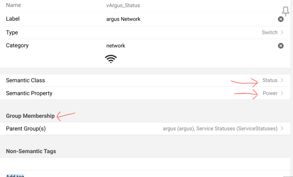

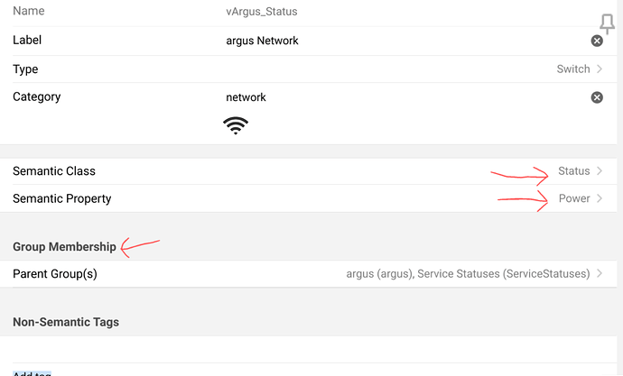

Equipment is usually represented as a Group. It’s location is set through which Location Group it is a member of. All the sensors and actuators that make up the Equipment are represented by Items that belong to it’s Group. You define whether a Group or Item is Equipment or a Point through Item tags. MainUI makes doing this relatively straight forward by presenting the semantic tags as separate options and have a drop down list of the allowable tags.
So, using MainUI, if you already have an Item that you want to make a point on an Equipment:
  1. Create the Equipment from the Model page and configure as appropriate
  2. Switch to the Items page and search/browse to the Item you want to add to the Equipment
  3. Click on edit and add the Item to the Equipment Group and set the Semantic Class and Property as appropriate.
There is an issue open to make it easier to select and modify existing Items as part of the Model. But there are more important issues being worked first.
