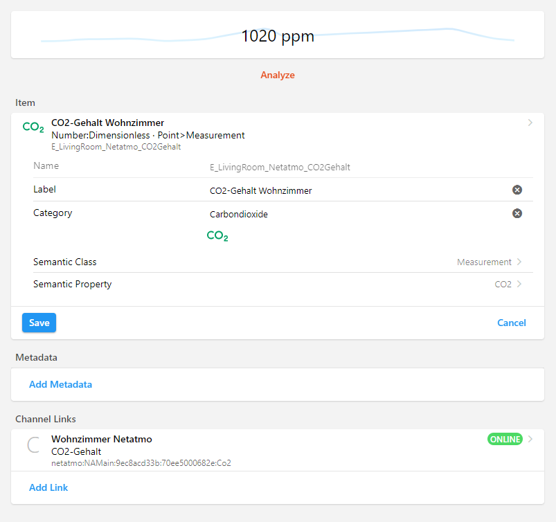

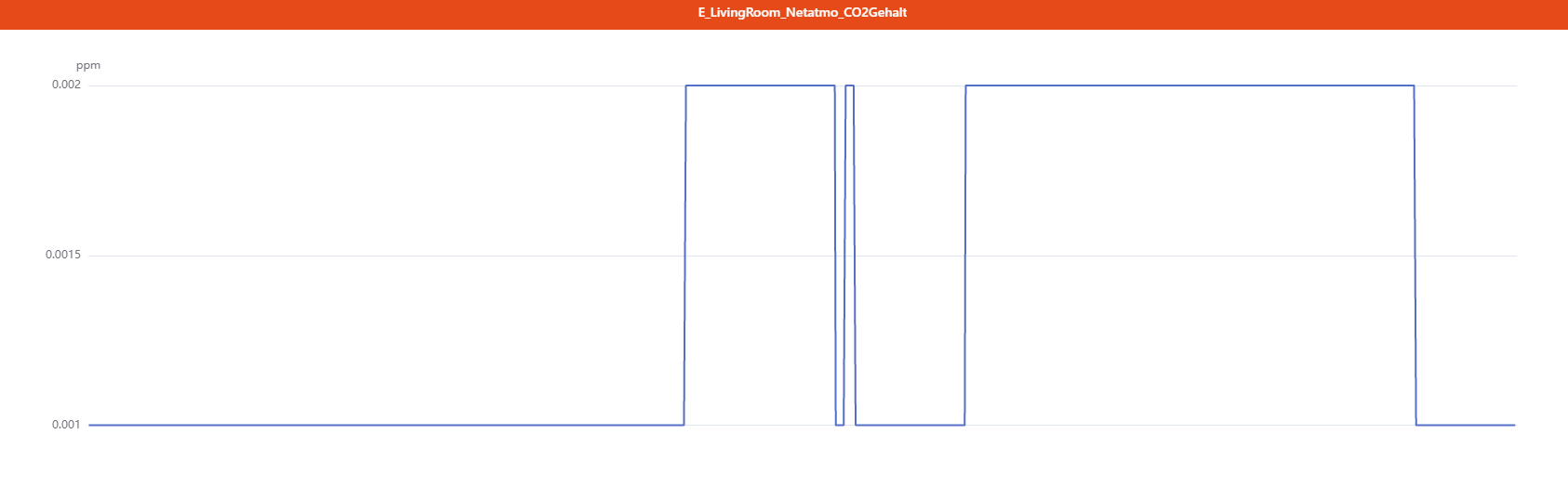

The Netatmo CO² shows in the widget correct 1020 ppm, but in the chart it is 0,001.
Is there a way to show the values also the same as the widget instead of 0,001 or 0,002 and so on?
Similar story here
If that doesn’t help, we’re going to need to know how your Item state metadata is configured.
Thanks, the solution was:
I see this as a minor deficiency in the UI charting.
Desirable behaviour -
If an Item has a default unit given in Item’s pattern metadata, use it for charting.
But it may not.
If an Item has an actual unit given in Item’s state - that is after all, a requirement for a Quantity type - use that for charting.
I suspect the reality is more about use of historical data from persistence, which relies on metadata to reconstruct units.
