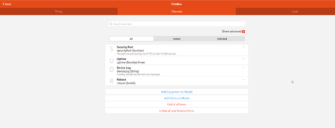

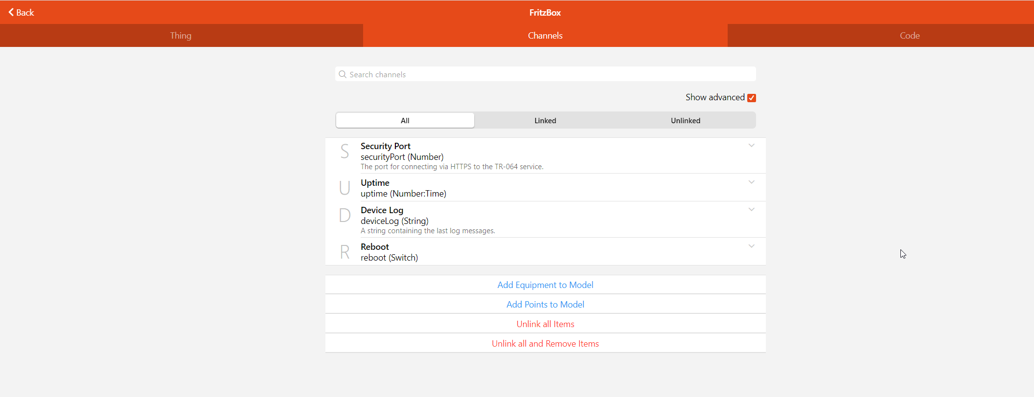

I also have an issue with OH3 version of the binding. In version 1 it was possible to switch ON/OFF Guest WIFI. The documentation of version3 of the binding also says, that there are channels available (with advanced options):
I turned on advanced options, but I’m not able to add guest wifi channel:
Any idea or hints?
Same issue. But 606 is when trying to set a value while 401 usually is sent while reading a value. How often is “sometimes”?
wrong device. use discovery to detect the subdevices.

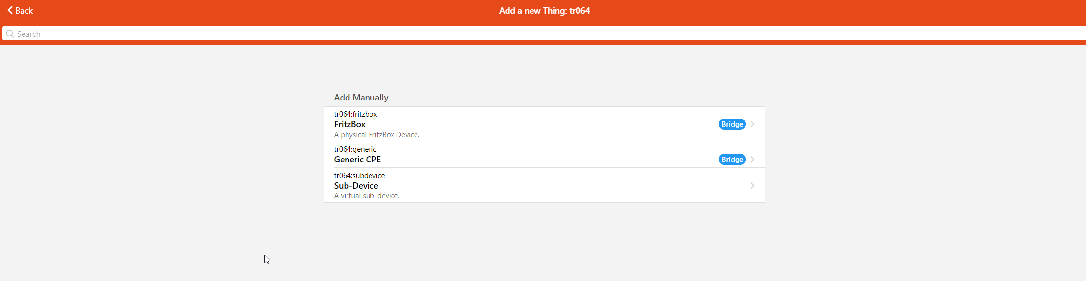

Stupid question:
How do I use discovery?
I only see the option to add manually…
When you choose the “Add” option, you will see a “Scan” button.
I don’t see the scan option:
After you created the fritzbox thing, go to the things configuration page, press “+”, select tr064 binding, press “Scan”. You’ll find a LANDevice. The wifi channels are on that device.

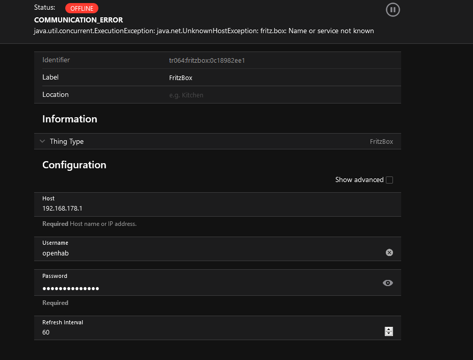

So a recreation of the Fritz!Box user solved the issue…
Another question: how can I create a maconline thing via text configuration?
@J-N-K maybe its caused by my network setup. Its splitt up in 192.168.178.x for smarthome wifi stuff and 192.168.50.x for normal devices incl. the OH3 server.
But both networks can route for communication (ping works for exapmle)
