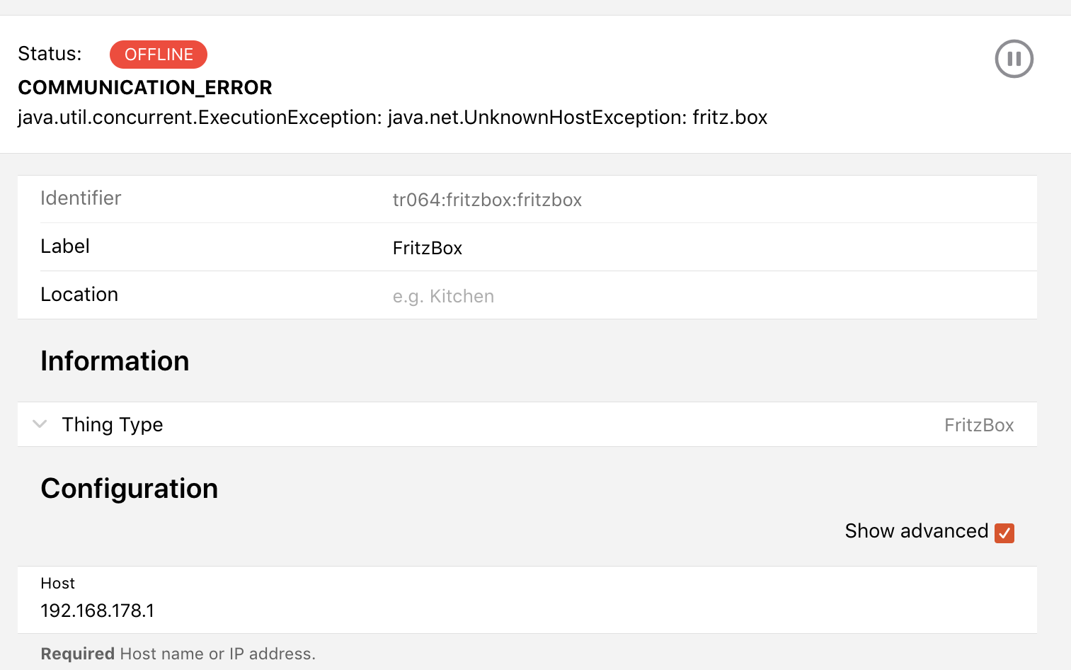

@J-N-K I just tested the tr-64 Binding in 3.0RC1 with strange results. I configured the hostname of the Fritzbox device to be 192.168.178.1, but it seems the binding tries to connect to “fritz.box” which my box does not resolve to. Please see the attached screenshot:
See my post here: OH3 TR-064 binding missing channels - #9 by alexxio
Thanks for the hint!
The question still is: why is this happening. I have found an issue, that might be the culprit. Would youl ike to try update org.openhab.binding.tr064 https://janessa.me/esh/org.openhab.binding.tr064-3.0.0-SNAPSHOT.jar?
