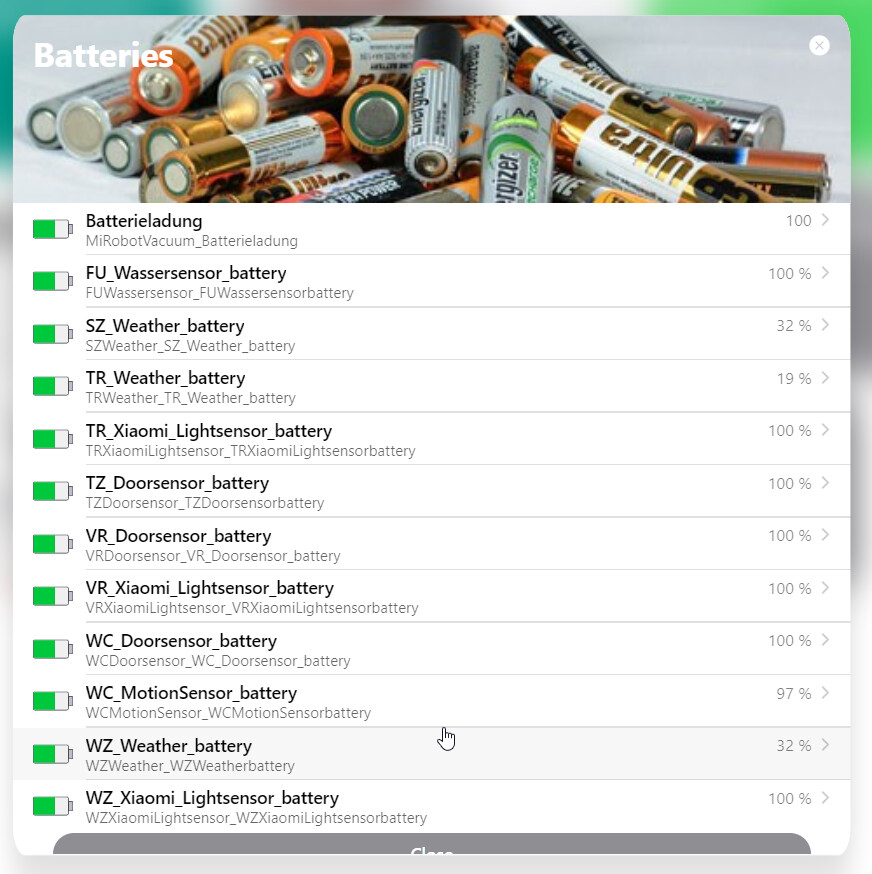

To change a type of semantic class (from Point to Equipment), you have to select None first to get rid of the filter, then you can select Battery under Equipment.
Then you will have a Batteries card in the Equipment tab (not the Property tab).

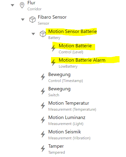

So, please allow one question:
Should the Battery (Group Equipment) containing “level” and “lowbattery” (see above) show up on the location → corridor → Fibaro sensor?
Because I don’t see the battery there (it shows up under equipment / battery though)
