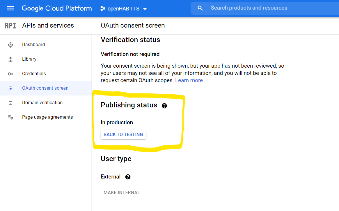

Please make sure that your Google developer console project is in “production” and not in testing state. Otherwise it will kick you out every two weeks as far as I remember…
The setting is a little hidden in the Google cloud console but have a look and I think you’ll find it. If not I can make a screenshot tomorrow.

Thanks Bob. I think I found it:
Have moved to production so will monitor and see how it goes.
