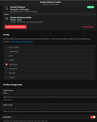

I added the GPSTracker with the GPSLogger app to my system and trying to add a Presence Switch with using the Channel Profiles to the System.
I used the System Distance Channel (Number:Length)
I configured a Number:Length Item and a Switch item:

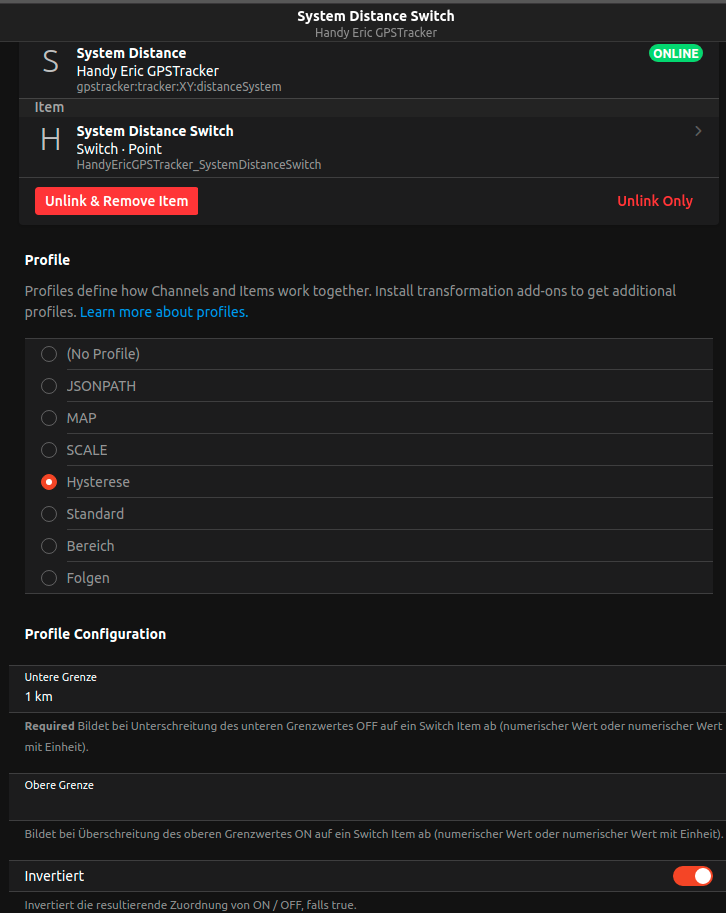

The Switch Item was configured with the HYsterese Profile:
But i get the following error in the Log:
2021-05-25 08:32:34.601 [WARN ] [e.internal.SseItemStatesEventBuilder] - Exception while formatting value βONβ of item HandyEricGPSTracker_SystemDistanceSwitch with format β%.2f %unit%β: Conversion = βuβ
Is this a Problem with the UoM ?
I tried already with other profiles, but got always the same errorβ¦
Anybody have an Idea? Or should i use a Rule for this?
