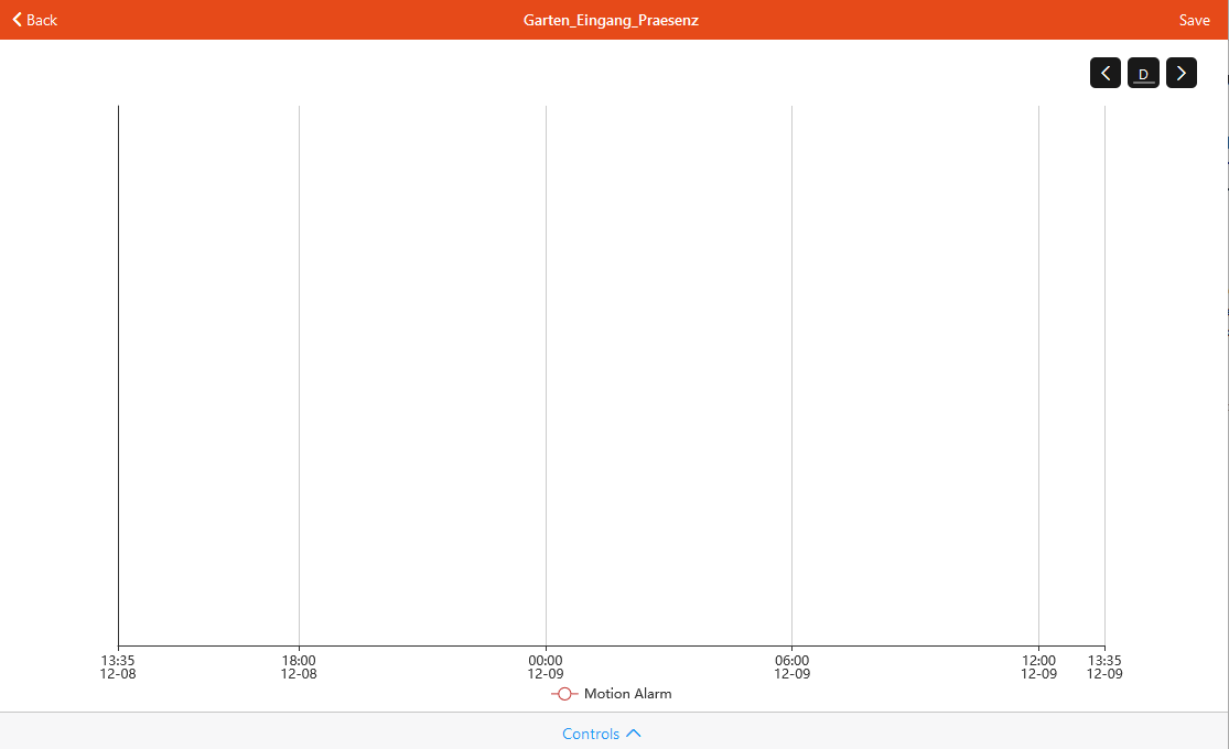

I have a motion detector which state is persisted. However when I’m creating a graph and use the analyze feature, I only see a blank page:
For numeric data, it’s working fine, though.

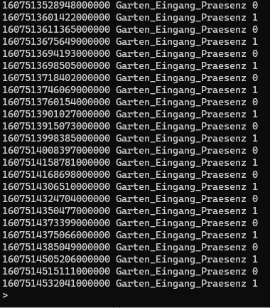

I checked that the data is present in influxdb:

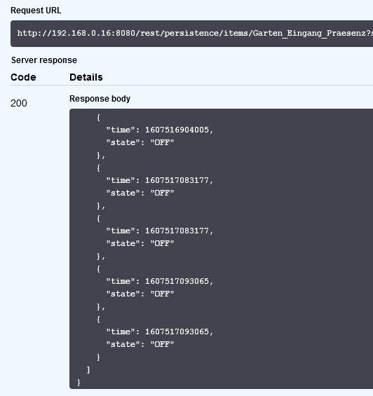

When I’m looking at the API
it only says “OFF” all the time. Is there some kind of mapping which is missing here?
