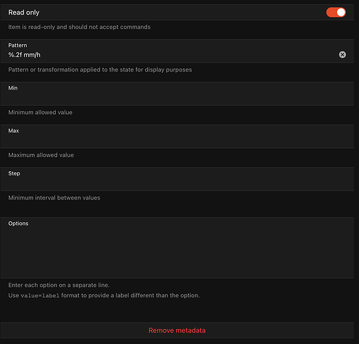

The ‘pattern’ part of the Item’s state presentation metadata sets the default unit for that Item.
Doesn’t the pattern attribute only alter the displayState attribute?
For what it’s worth, the Group Item has the pattern set to %.2f mm/h but items.itemName.state returns a value in km/h.
It is possible though that I set the pattern attribute after creating the Group Item. Would that explain the difference?

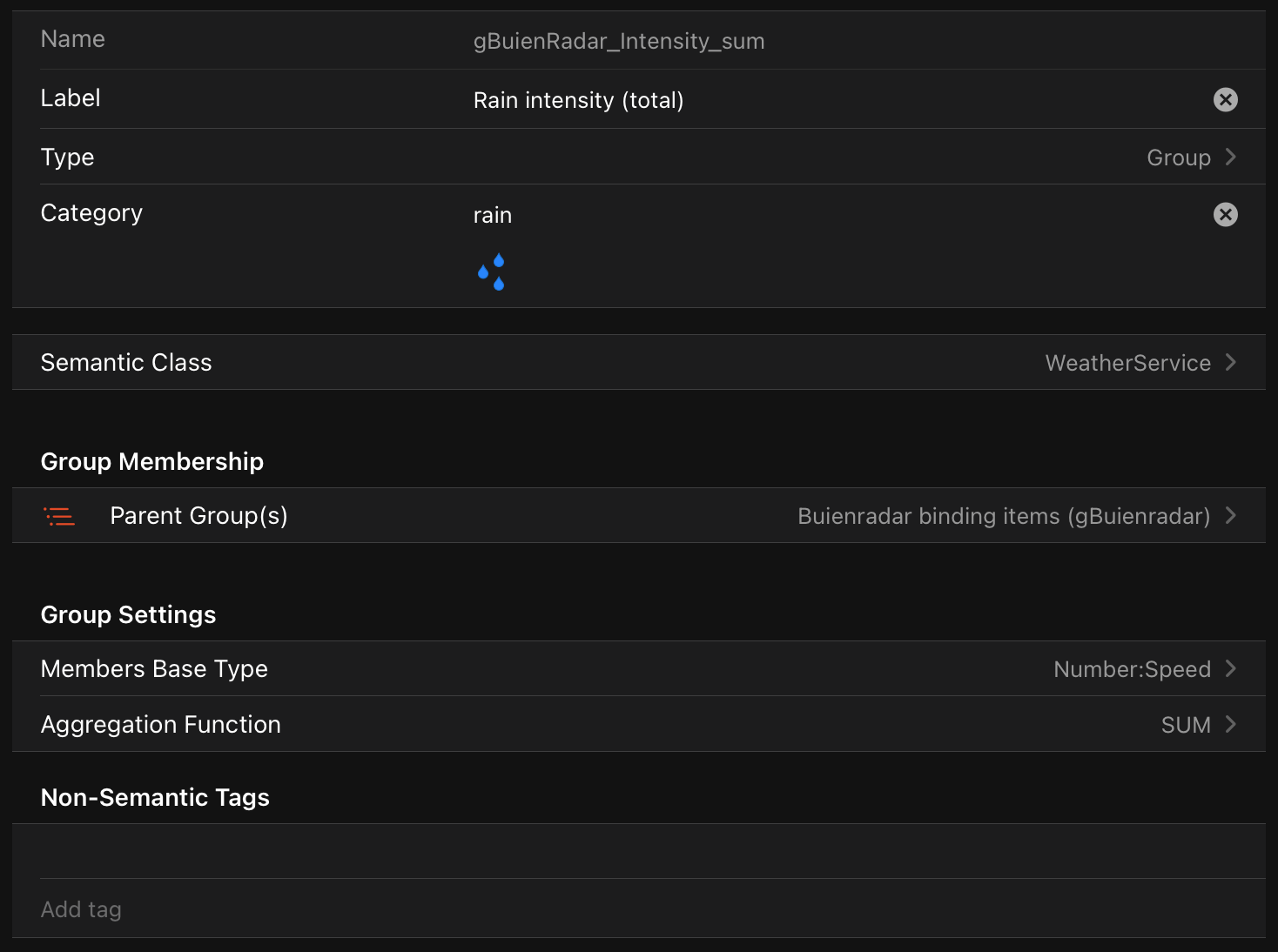

Here’s the Item definition:

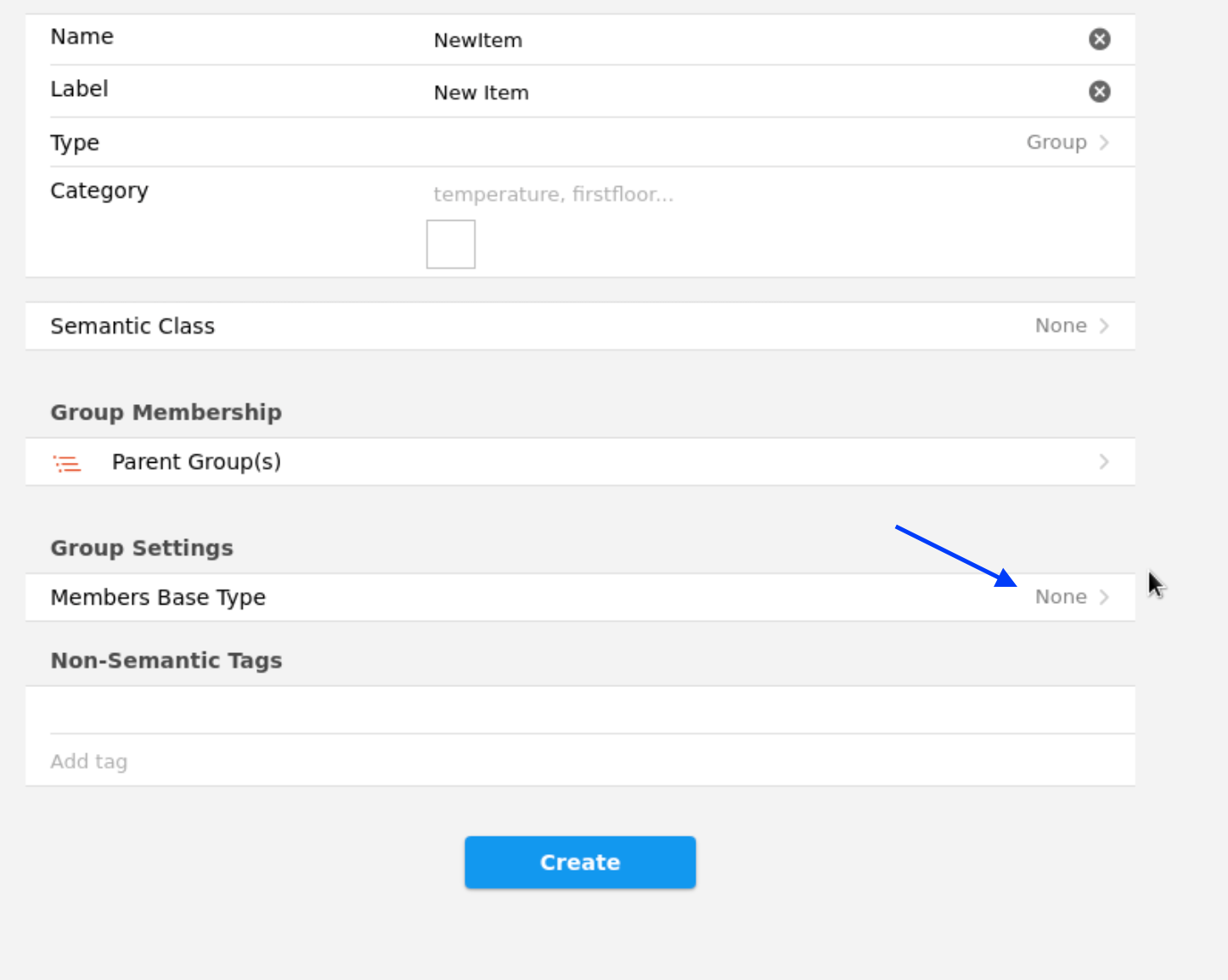

To my knowledge there is no way to set the Group subtype through Main UI; you can only assign it by pasting an openHAB2-style Item definition (using the appropriate tags). For Items, it’s a trivial thing to do.
Here’s the “state description” metadata configuration:

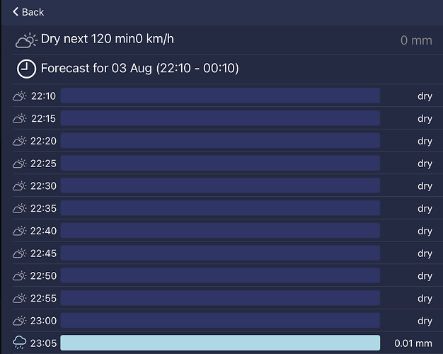

Here’s a rendering of my custom widget with items.itemName.state clearly showing a value in km/h (1st line):
I know I can get the ‘formatted’ state through items.itemName.displayState but this again implies prior/implicit knowledge of the units when parsing the state in YAML (e.g., by using Number.parseFloat() or by splitting the state at the first white space character.

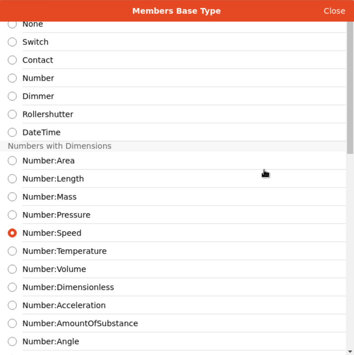

I think perhaps that is present but mislabelled as “Members Base Type”. It’s legitimate to have mixed types as members of a Group, so the label is a bit of a nonsense really.
If in doubt, it will be plain in the API Explorer JSON version.

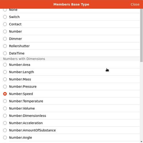

That sets the Group’s type to Number:Speed.

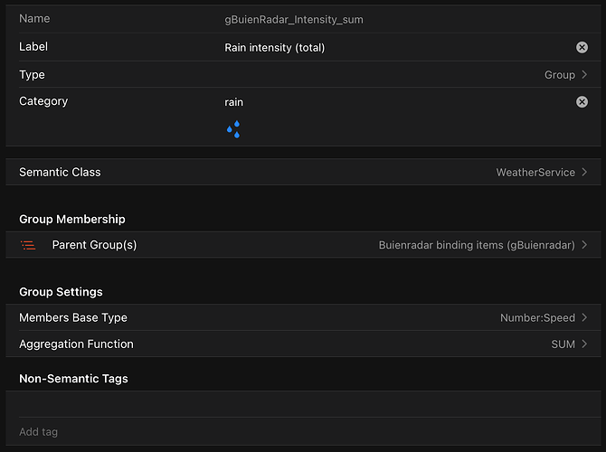

Based on your screen shot above you have explicitly configured the Group to be of type Number:Speed.

The formatted state through displayState is exactly how you are supposed to specify the units you want to display that Item’s state in MainUI. I fail to see the problem here I guess. You know the Item is a Number:Speed. You know the members of the Group are also Number:Speed. You know that the speeds are small. So you know everything you need to know to specify that you want to show the speed as mm/h which you specify using the state description and using the displayState in the YAML for the widget. That’s what the displayState is there for; to specify how you want that Item’s state to be displayed up to and including which units to display it as.
It’s simply not technically feasible. But what would that do for you that the displayState doesn’t already?
I’m sure Yannick will consider an alternative if a better one is presented. I can’t come up with anything that is any better. It’s a hard thing to distill down to a simple label.
That’s exactly what the “state description” metadata pattern does and to access that choice use displayState instead of state. That ability is already there and it’s available in the widget anywhere you can access the Item’s state in the widget definition.
But it’s tied to the Item, once and forever. In a sitemap, you can display e.g. a single temperature quantity in three different units by use of label= overriding what the Item says. It’s under the control of the UI designer, separating Item property from display presentation.
