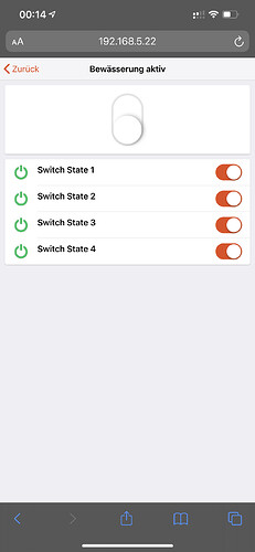

I did some further testing.
Deleted the Docker Container and run a new instance OH3.1.0M3 from scratch.
Set group item gBewaesserung_Aktiv
with APIExplorer to ON
All member items and the group item changed to ON
immediately, as expected.
2021-04-09 23:22:50.213 [INFO ] [openhab.event.ItemCommandEvent ] - Item 'Bewaesserung_Unten_Status' received command Aus
2021-04-09 23:24:00.517 [INFO ] [openhab.event.ItemCommandEvent ] - Item 'gBewaesserung_Aktiv' received command ON
2021-04-09 23:24:00.517 [INFO ] [openhab.event.ItemCommandEvent ] - Item 'item_HM_Sw4_Bewaesserung_1_STATE' received command ON
2021-04-09 23:24:00.517 [INFO ] [openhab.event.ItemCommandEvent ] - Item 'item_HM_Sw4_Bewaesserung_2_STATE' received command ON
2021-04-09 23:24:00.517 [INFO ] [openhab.event.ItemCommandEvent ] - Item 'item_HM_Sw4_Bewaesserung_4_STATE' received command ON
2021-04-09 23:24:00.517 [INFO ] [openhab.event.ItemCommandEvent ] - Item 'item_HM_Sw4_Bewaesserung_3_STATE' received command ON
2021-04-09 23:24:00.519 [INFO ] [openhab.event.ItemStateChangedEvent ] - Item 'item_HM_Sw4_Bewaesserung_1_STATE' changed from OFF to ON
2021-04-09 23:24:00.519 [INFO ] [openhab.event.ItemStateChangedEvent ] - Item 'item_HM_Sw4_Bewaesserung_2_STATE' changed from OFF to ON
2021-04-09 23:24:00.519 [INFO ] [hab.event.GroupItemStateChangedEvent] - Item 'gBewaesserung_Aktiv' changed from OFF to ON through item_HM_Sw4_Bewaesserung_1_STATE
2021-04-09 23:24:00.519 [INFO ] [openhab.event.ItemStateChangedEvent ] - Item 'item_HM_Sw4_Bewaesserung_4_STATE' changed from OFF to ON
2021-04-09 23:24:00.519 [INFO ] [openhab.event.ItemStateChangedEvent ] - Item 'item_HM_Sw4_Bewaesserung_3_STATE' changed from OFF to ON

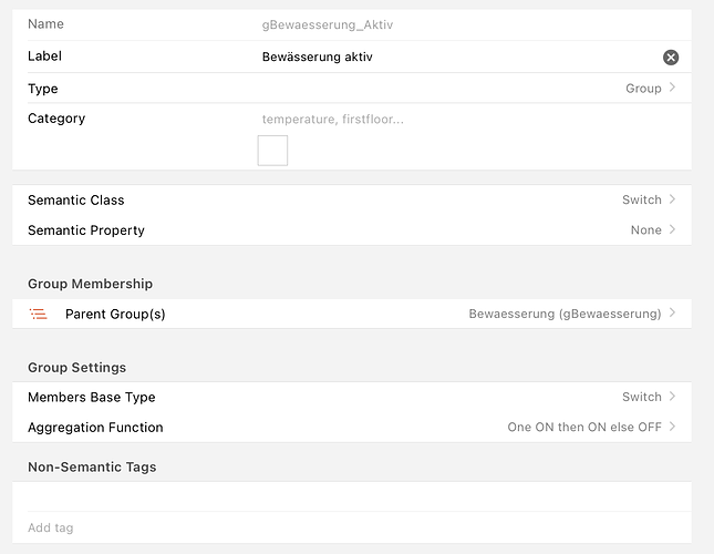

"groupType": "Switch",
"function": {
"name": "OR",
"params": [
"ON",
"OFF"

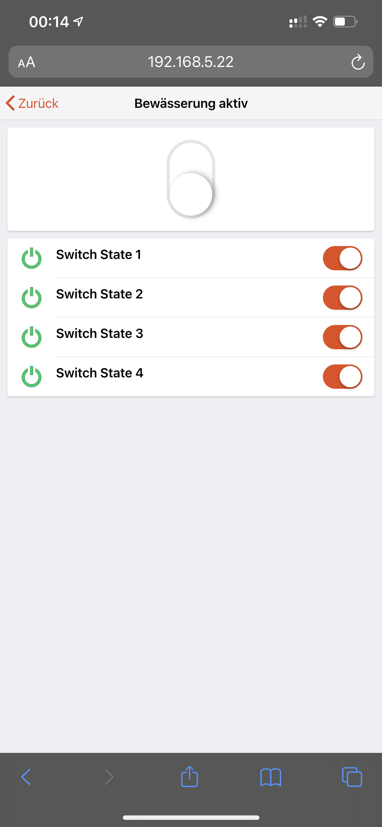

- set group item
gBewaesserung_Aktiv
back to OFF
2021-04-09 23:25:08.222 [INFO ] [openhab.event.ItemCommandEvent ] - Item 'item_HM_Sw4_Bewaesserung_1_STATE' received command OFF
2021-04-09 23:25:08.222 [INFO ] [openhab.event.ItemCommandEvent ] - Item 'item_HM_Sw4_Bewaesserung_2_STATE' received command OFF
2021-04-09 23:25:08.222 [INFO ] [openhab.event.ItemCommandEvent ] - Item 'item_HM_Sw4_Bewaesserung_4_STATE' received command OFF
2021-04-09 23:25:08.222 [INFO ] [openhab.event.ItemCommandEvent ] - Item 'item_HM_Sw4_Bewaesserung_3_STATE' received command OFF
2021-04-09 23:25:08.223 [INFO ] [openhab.event.ItemStateChangedEvent ] - Item 'item_HM_Sw4_Bewaesserung_1_STATE' changed from ON to OFF
2021-04-09 23:25:08.223 [INFO ] [openhab.event.ItemStateChangedEvent ] - Item 'item_HM_Sw4_Bewaesserung_2_STATE' changed from ON to OFF
2021-04-09 23:25:08.223 [INFO ] [openhab.event.ItemStateChangedEvent ] - Item 'item_HM_Sw4_Bewaesserung_4_STATE' changed from ON to OFF
2021-04-09 23:25:08.223 [INFO ] [openhab.event.ItemStateChangedEvent ] - Item 'item_HM_Sw4_Bewaesserung_3_STATE' changed from ON to OFF
group item is still ON

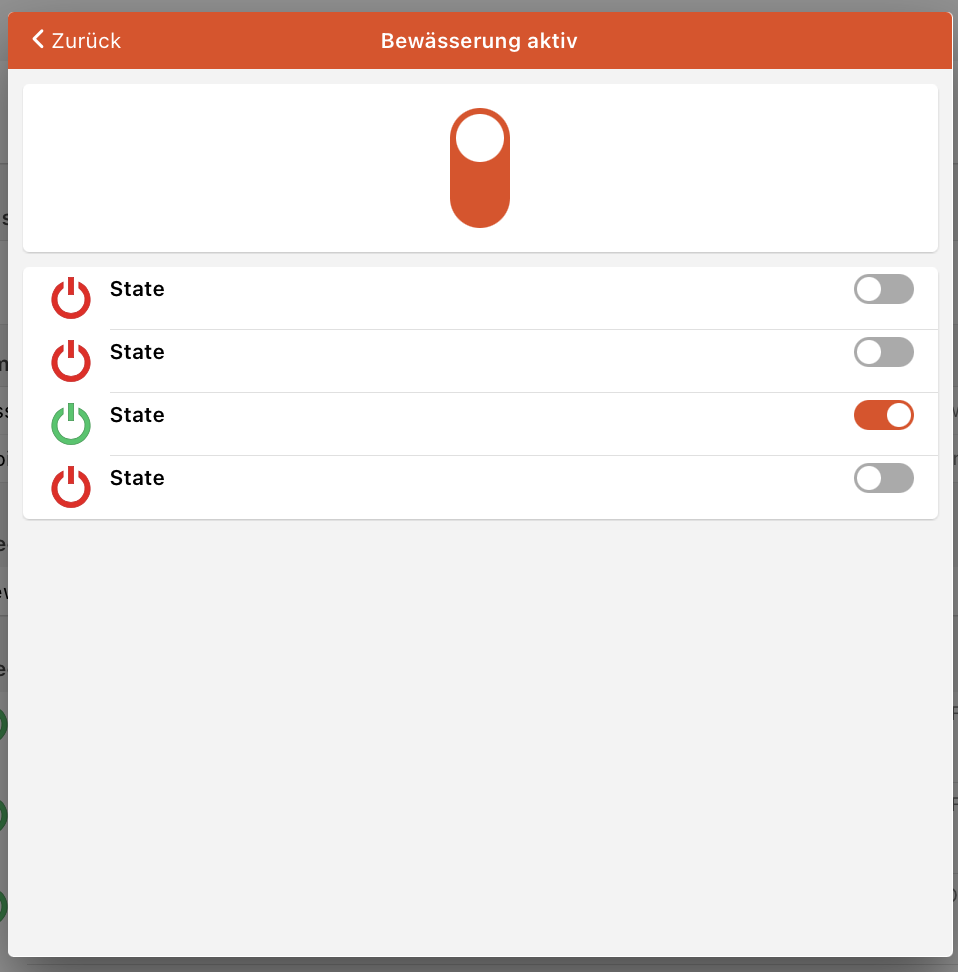

- next I change the member item
to ON
2021-04-09 23:30:17.407 [INFO ] [openhab.event.ItemCommandEvent ] - Item 'item_HM_Sw4_Bewaesserung_3_STATE' received command ON
2021-04-09 23:30:17.407 [INFO ] [openhab.event.ItemStateChangedEvent ] - Item 'item_HM_Sw4_Bewaesserung_3_STATE' changed from OFF to ON
However, group state remains OFF
"members": [
"link": "http://192.168.5.22:8192/rest/items/gBewaesserung_Aktiv",
"state": "OFF",
"type": "Switch",
"name": "item_HM_Sw4_Bewaesserung_1_STATE",
"label": "Switch State 1",
"category": "Switch",
"tags": [
"Point"
"groupNames": [
"gBewaesserung_Aktiv",
"item_HM_Sw4_Bewaesserung"
"state": "OFF",
"type": "Switch",
"name": "item_HM_Sw4_Bewaesserung_2_STATE",
"label": "Switch State 2 ",
"tags": [
"Point"
"groupNames": [
"state": "OFF",
"type": "Switch",
"name": "item_HM_Sw4_Bewaesserung_4_STATE",
"label": "Switch State 4",
"tags": [
"Point"
"groupNames": [
"state": "ON",
"type": "Switch",
"name": "item_HM_Sw4_Bewaesserung_3_STATE",
"label": "Switch State 3",
"tags": [
"Point"
"groupNames": [
"function": {
"name": "OR",
"params": [
"ON",
"OFF"
"state": "OFF",
"editable": true,
"type": "Group",
"name": "gBewaesserung_Aktiv",
"label": "Bewässerung aktiv",
"category": "",
"tags": [
"Switch"
"groupNames": [
"gBewaesserung"
This time it took approx. 86sec to get the group item state changed…

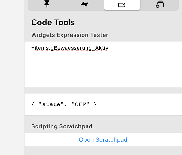

"OFF"
"state": "ON",
"editable": true,
"type": "Group",
"category": "",
"tags": [
"Switch"
"groupNames": [
"gBewaesserung"
Can I do some more detailed TRACES to narrow down the issue?
Let me know if you want me to test something else, which can help to find the root cause of the problem.
Thanks for your support
Stefan
