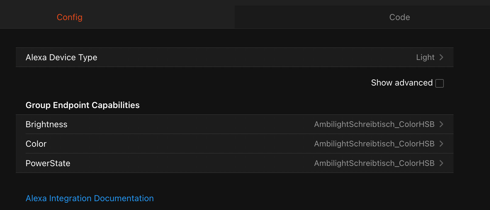

I created a group (g_Schreibtisch) for Brightness, Color HSB and Power.
This works fine. Everything can be controlled as one item (added Alexa Metadata).

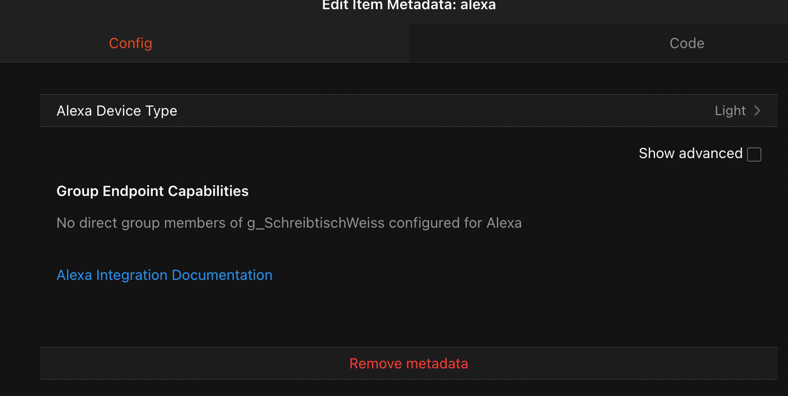

Since I don’t think RGB + W works with Alexa, I tried splitting it up:
one more group, g_SchreibtischWeiss which includes the White Element and also the Dimmer.
But there I can’t setup the deployed items in the Meta Data
