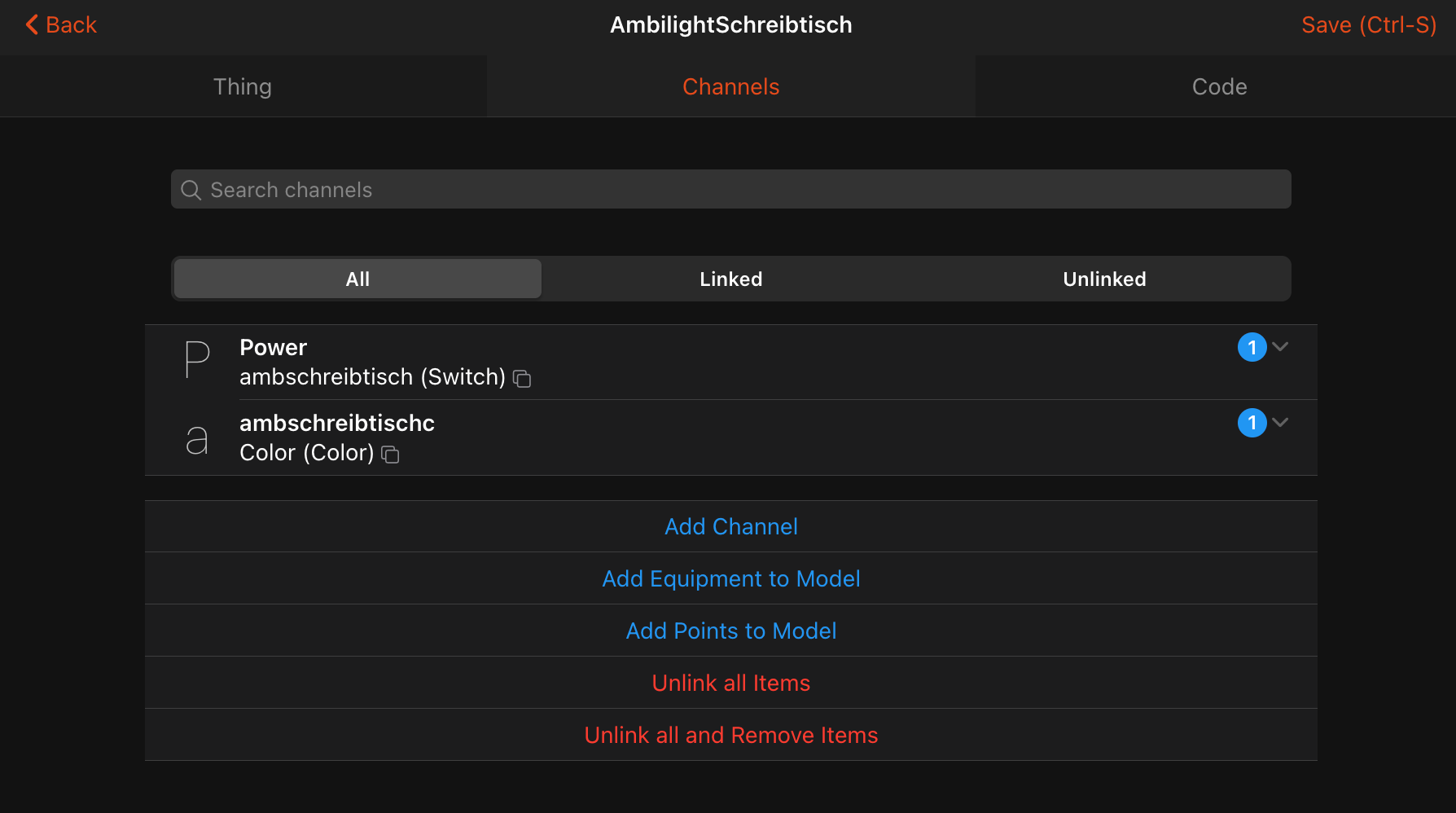

I added an channel for POWER and another for color, but I’m not able to do anything at the color (no options).

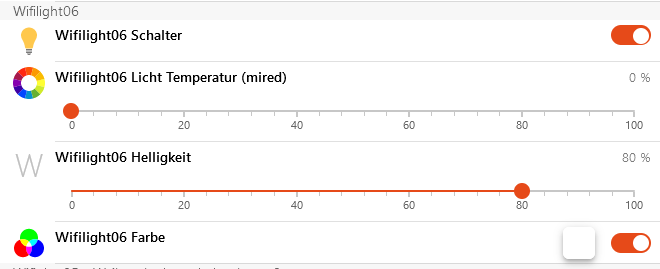

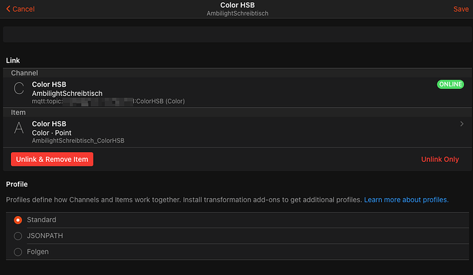

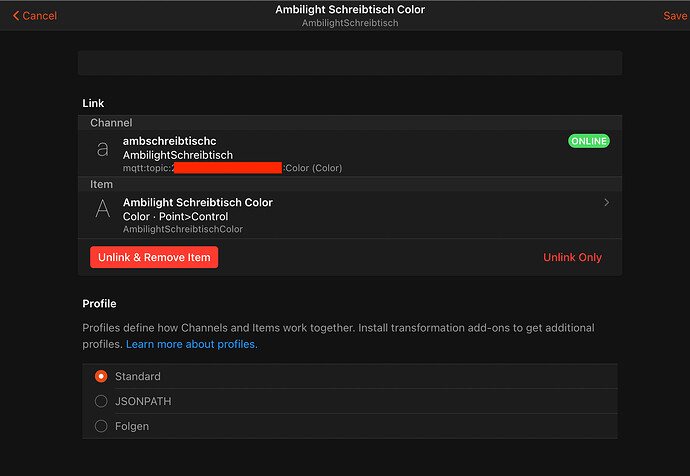

Each channel is linked to a corresponding item (like your Ambilight Schreibtisch Color, which looks perfectly fine). If all items have “Property_Light” set you can now operate all items in MainUI, in tab “Equipment” on the card “Lights”. In my case it looks like this:
After pressing the color picker button (white square beside the switch in the last line) and selecting a color the openHAB sends the command cmnd/Wifilight06/HSBCOLOR 207,0,100 to Tasmota and the light turns blue(-ish).
When changing the color temperature to a value between 153 and 500 the bulb is white again.
Does this help?

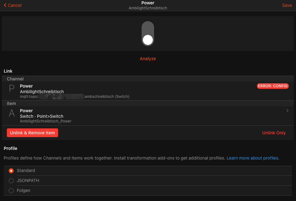

I’ve tried setting it up now, but it doesn’t work.

And now even the power button isn’t working anymore (not sending or changing state)

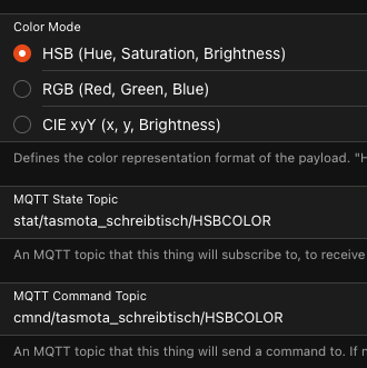

Perhaps you are a victim of this bug: https://github.com/openhab/openhab-addons/issues/10117 ?
I don’t think this was the direct reason, but when troubleshooting I saw that the option
colorMode: HSB
was missing. Clicked around a bit (reselected HSB, save, …) and it was in Code.
Now this error isn’t shown anymore and Power Works.
But I’m still not done :wink:

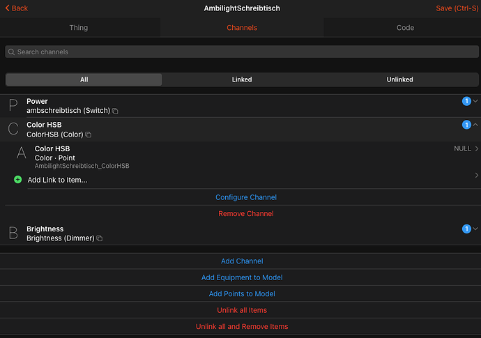

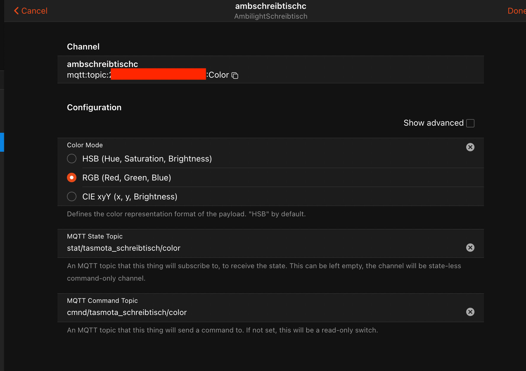

Color(HSB) still has no options:
and state Null.
and when using the Brightness Color Temp changes from warm white (set via Tasmota) to an “artifical cold white”.

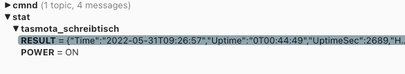

Strange. I see the stat/tasmota_name/HSBCOLOR mqtt topic coming from Tasmota. Can you send the HSBOLCOR command manually over MQTT Explorer (cmnd/tasmota_schreibtisch/HSBCOLOR) with contents e.g. 135,0,100 and check if you see the corresponding stat message in MQTT Explorer and in openHAB?
I can see the message in the MQTT Explorer when sending the HSBColor command:
Thing in OpenHAB is still null.
But I just saw, that even the Power in OpenHab doesn’t get updated (/POWER, …). But in this case it can be turned on/off via openhab.
POWER must be upper-case
commandTopic: cmnd/tasmota_schreibtisch/POWER
stateTopic: stat/tasmota_schreibtisch/POWER
And for HSBColor try
stateTopic: stat/tasmota_schreibtisch/RESULT
