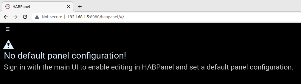

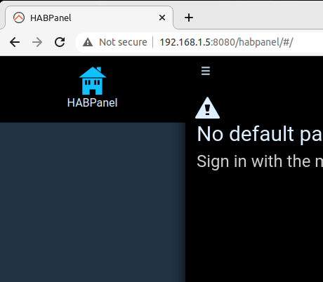

When I remove the word TrialPanel, I get this screen:
Clicking on the hamburger, results in this:
But there is no TrialPanel entry I can select.
The docs says: got to PaperUI and Configuration, which does not exist in MainUI.
Yes, I looked at all menu items, but can’t find anything related to HABpanel.

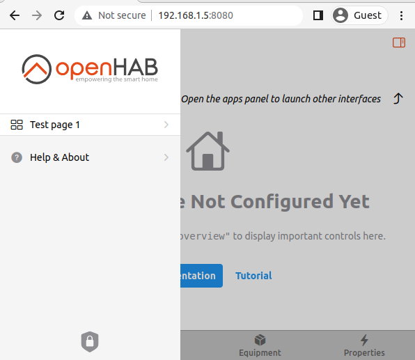

a) open the OH main UI, by calling http://:8080
This should result in this:
b) click on the red ‘burger’ on the top left of the screen
… a shield with a log appears on the bottom left.
c) click this icon and log into openHAB
… the screen looks the same as under a)

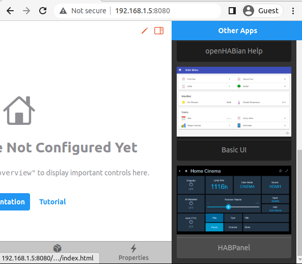

d) now click on this icon image found in the top right corner.
A side menu opens, similar to this (assuming HAPpanel was installed)

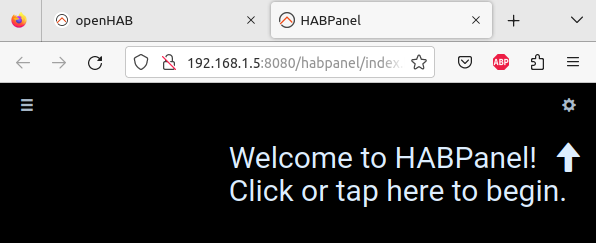

e) click on HAPpanel
A screen similar to this appears

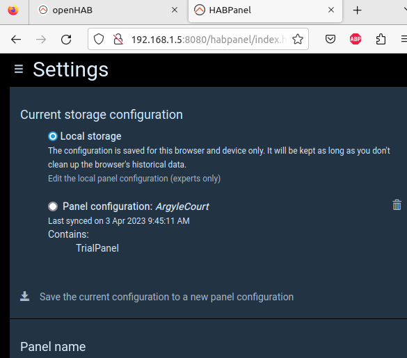

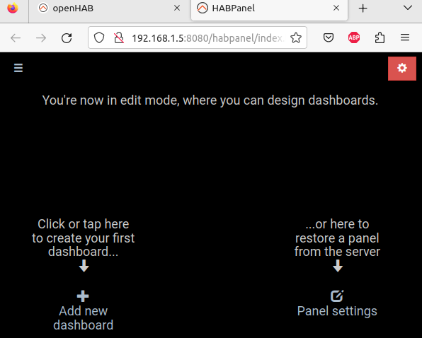

f) Click on the gear icon in the top right corner.
g) click in the area saying "restore a panel from the server

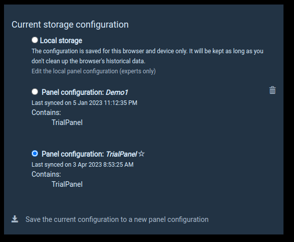

Excursion:
If you have never saved your self-designed HAPpanel to the opeHAB server, there will be no option to select a ‘Panel Configuration’ from the screen above.
Hence, you need to go back to your browser where you configured your HAPpanel and save it to the server (give it a name, etc.)

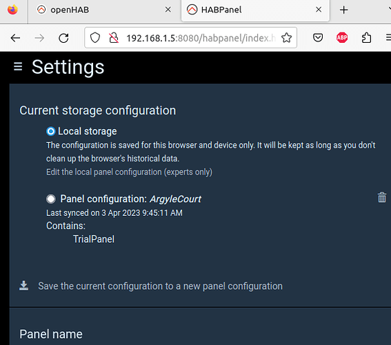

h) Tick any one of the panels you may have available (mine is called ArgyleCourt)

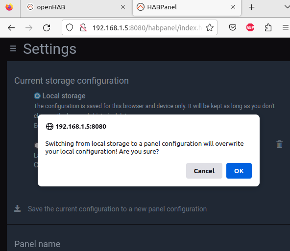

i) click OK, and select your panel.

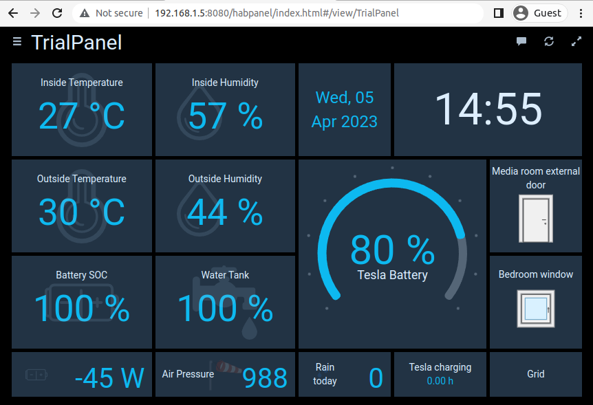

Done.
In my case this:
