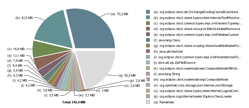

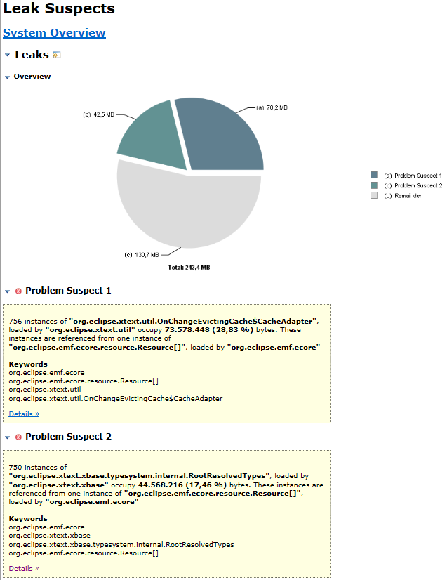

From the heap analyzer I can see that there is a Java-Map that has an enormous amount of entries, but I couldn’t find it the the code.

On your screenshots the heap size looks to be ~250mb, have you seen it grow any bigger than that?
