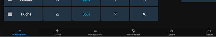

It’s not ā€œhidingā€ but you can make it translucent, by adding these styles to the page config:
--f7-bars-bg-color: none
--f7-bars-border-color: none
--f7-navbar-shadow-image: none
--f7-bars-translucent-opacity: none
--f7-bars-translucent-blur: none
backdrop-filter: none

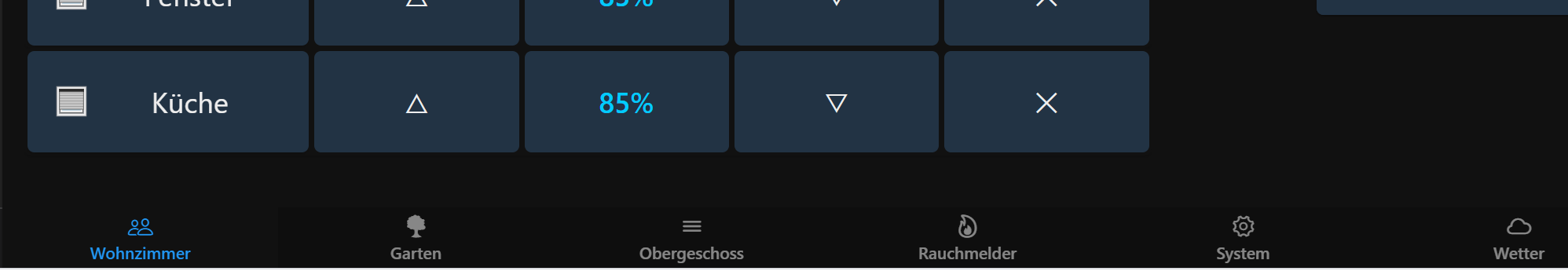

You can also remove the top/bottom offset & padding, if you want to use the full space - but keep in mind, that the navbar title and the control elements will still show up.
    --f7-page-navbar-offset: none
    --f7-page-toolbar-top-offset: none
    --f7-page-subnavbar-offset: none
    --f7-page-searchbar-offset: none
    --f7-page-content-extra-padding-top: none
    --f7-page-toolbar-bottom-offset: none
    --f7-page-content-extra-padding-bottom: none

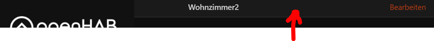

I also had to realize that changing navBars’ properties does not remove the ā€œtop barā€.
all these properties
could be replaced by --f7-navbar-height: 0px but that just shifts the whole page to the top and the page is still overlayed by another bar containing elements of the MainUI like this:

These style variables does not do the same - the f7-navbar-height: 0px will sets the height of the topbar to 0px and moves all contents below up by the topbar-height respectively (including the title and the controls/actions in it) - the mentioned css variables will only set the offset / padding to 0 and still shows the topbar with its control-elements.
The combination of the removed offset / padding…
…and the transluscent topbar…
…is the closest to get rid of the (maybe not needed) offset / padding and making the topbar translucent, without sacrificing the title (which you could also ā€˜remove’ by adding --f7-navbar-title-font-size: 0, if needed) and important control-elements (like edit and the menu toggle).
translucent_title

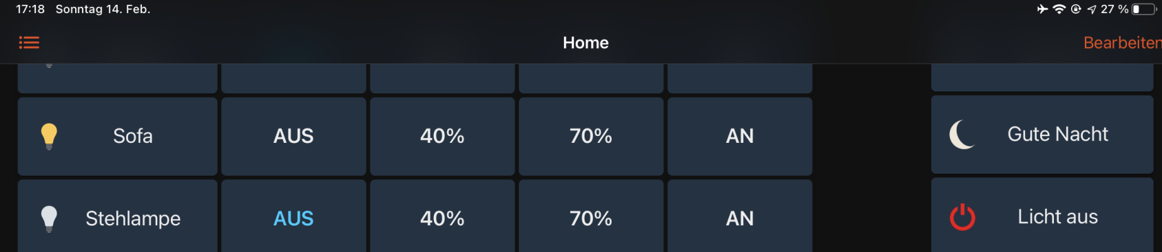

hmmm. On an iPad it does not show any difference with the setting you provide:
  label: Wohnzimmer
  style:
    --my-font-size: 1.3rem
    --my-font-color: "#EEEEEE"
    --my-font-color-active: "#00CCFF"
    --my-bg-color: "#223344"
    --my-bg-color-active: "#22334499"
    --my-border-radius: 5px
    background: "#111111"

Hmm, you`re right.
It works on every device I tested it with - seems like these styles…
--f7-bars-translucent-opacity: 0.8;
--f7-bars-translucent-blur: 20px;
…got set by another root component and overwrites the styles for iOS. You should switch to Android :crazy_face:

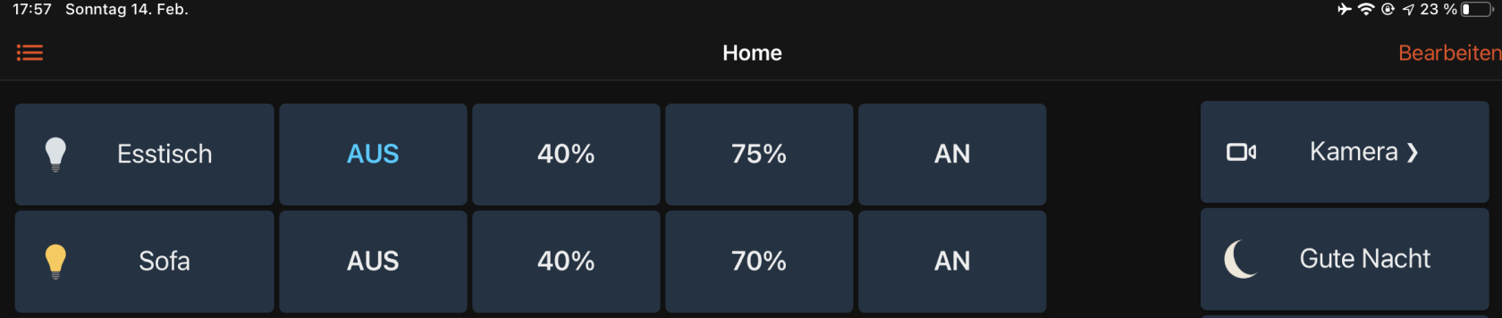

this works fine for desktop or android based browsers but for any reason not on iOS. I mean not at all working. It does not change a single pixel…
Anybody knows why or what I need to differently?
