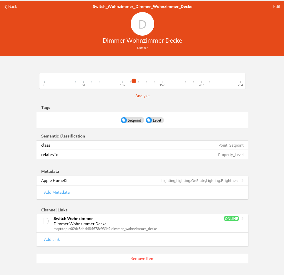

I want to dim my light via Homekit.
Setting the brightness of the thing in OH3 works, and the dimmer also shows up in Homekit.
But changing the brightness in Homekit does neither affect the value in OH3, nor the brightness of my light.
The Homekit metadata:
value: Lighting,Lighting.OnState,Lighting.Brightness
  dimmerMode: normal
  minValue: 0
  maxValue: 254
the configuration looks correct.

I checked the openHAB logs. In the openhab.log file, I noticed the line:
2023-08-11 11:02:56.092 [WARN ] [ssories.HomekitCharacteristicFactory] - Item type Number is not supported for Switch_Wohnzimmer_Dimmer_Wohnzimmer_Decke. Only ColorItem and DimmerItem are supported.
I choose Number and not Dimmer as type because my physical dimmer expects values between 0-254 and dimmer seems only to send floating numbers between 0-1.
