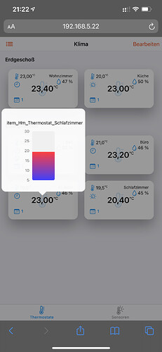

I’m building widget which should be used for Homematic Thermostat Control.
Currently I’m stuck with the temperature control using a Popover.
As you can see in the screenshot, the temperature I set for one room is somehow “cloned” to the other rooms as well.
I have added a label for debugging the issue, and this clearly indicate that the item used in the Popover is not refreshed - its always for the same room.
Do I need to clear or reset this somewhere?
Thanks Stefan
Correct:
Wrong: The item still refers to the Widget of the previously opened Popover

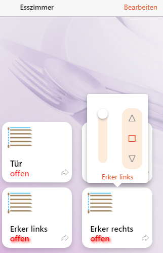

i have similar issues when having more than one popover widget in one site. what works with me is to click again on the popover, then it changes to the right one. my current workaround is using popup instead of popover, but this is just second best.
Clicking twice doesn’t work with with popover :frowning: the popover is always inheriting the wrong item. I suppose this is a bug. Maybe @ysc can advise?

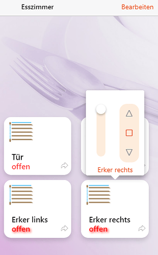

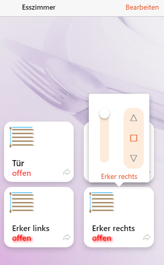

here are two screenshots with the behaviour i see with more than one popover in a page:
a click on the widget opens the popover. the right popover appears: correct!
if i now click again on the right widget, the left the popover from the other, from the left widget appears.
clicking again on the widget, the correct popover appears and so on.
As said, for now i workaround with popup but i am sure there is a point somewhere to get this sorted.
