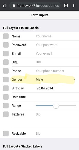

Thanks @bhomeyer , but I am trying to achieve something like here:
After clicking the selection list shall appear

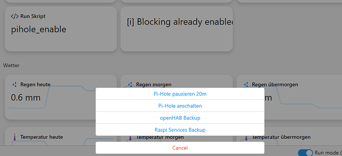

So, finally I found a solution - pretty easy one.
  1. Put the options I want to select into the Commad Options Metadata of the item
  2. Used Label cell, and selected command options as the action.
Maybe it helps someone who has the same question

Hi @tjarco,
Sorry for the late reply. I just selected command options in the actions section of the standard Label cell widget.
