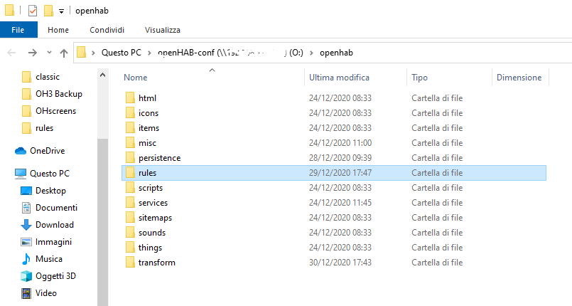

You can still run text file rules in OH3. Then you can use you global timers.
But I have to copy only the “body” inside a script like these
1)
Or copying the same rule of OH2 and paste here ?
2)
That :backhand_index_pointing_up:t2:
You can use the same folders as OH2.

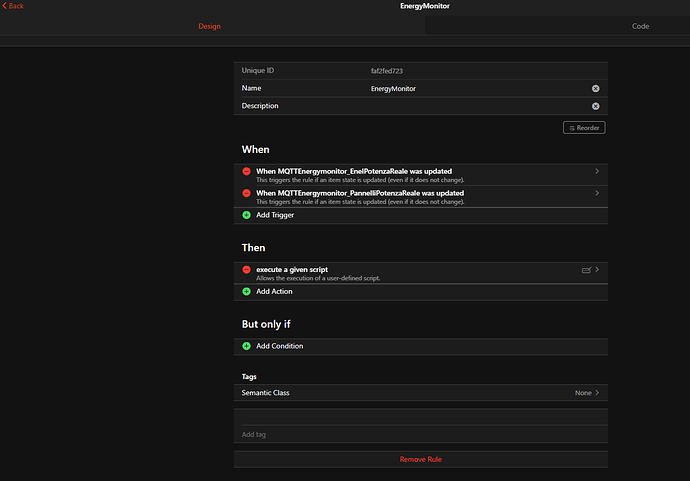

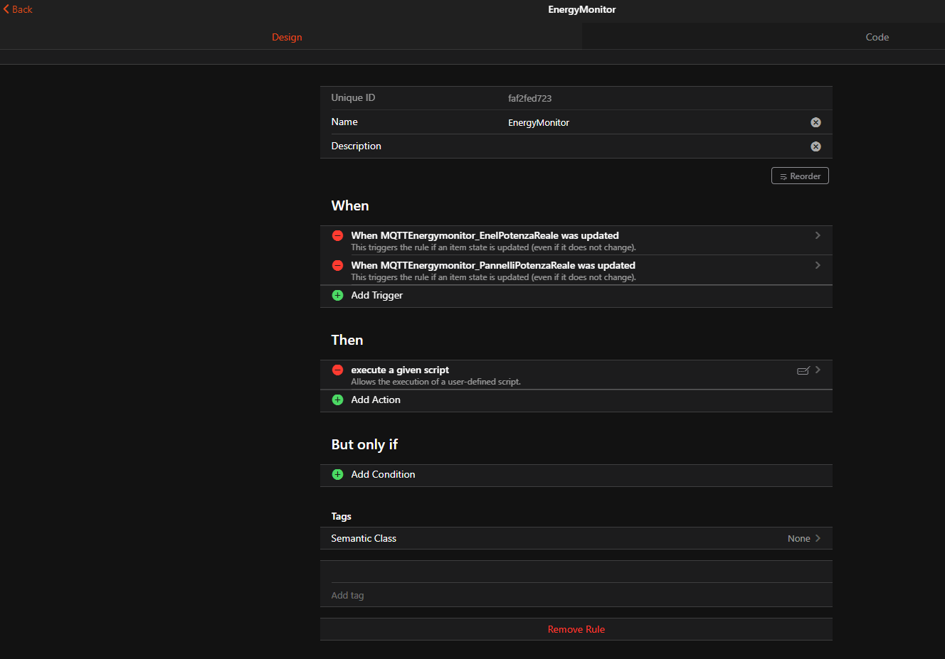

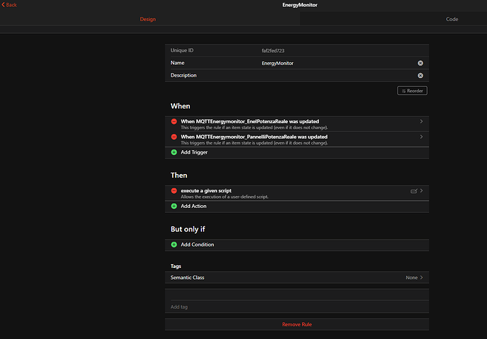

Can you post your OH2 rule?
Yes sure. and many thank you foy your help :star_struck:
It is basically an energy monitor for may fotovoltaic + normal energy system.
timers it to prevent alexa trigget continously the High consumption warning.

if copy paste, nether the first data update part, before alexa speack if, is executed
Or the PIR example as the topic title sais. not work neither too. the concept is the same for reschedule the timer…
