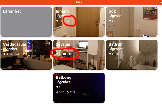

But, icon on locations card can’t change.
I created a lock item as Equipment_Door.
On location card, it appeared as unlocked door even it locked and Icon disappeared when it unlocked.
I have the same issue. Both with Locks and Blinds. When the OPEN symbol is showing they are actually closed so I would also like to know how to reverse it. I think we’re both speaking about the badges icons in the locations tab. I’m thinking about the State Description Meta Data tag. Is that used for situations like this?
I tried the Openhab Demo as well and when you press UP there on the fake demo blinds the Open Blinds symbol dissappears. Pressing DOWN and the Open Blinds symbols is visible.

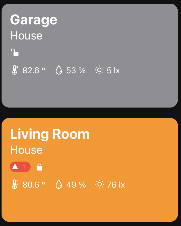

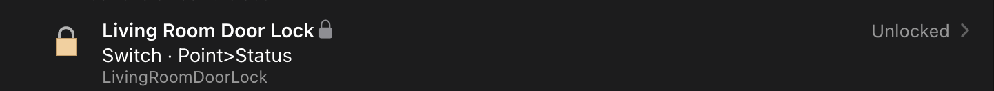

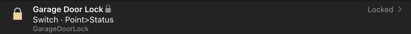

i’m on 3.1.0 and the icons are still reversed. As you can see from the screenshots below: Garage lock icon shows unlocked icon but the lock is locked, and Living Room lock icon shows locked but it’s unlocked. Was there any way to change/reverse this behavior?
