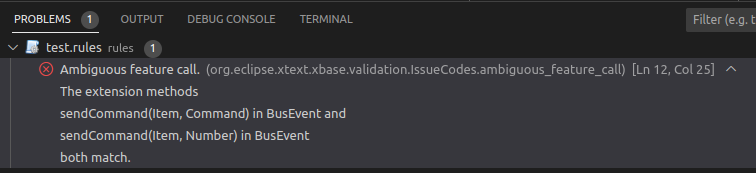

vsCode gives me a wiggly line under sendCommand.

Did you try simply: Shed_KDL_Colour.sendCommand(
new HSBType( “100,20,50”))
Or: sendCommand(Shed_KDL_Colour, new HSBType(“100,20,50”))
Command is picky about what type of object you send; generally a string is ‘safe’ as it will try to parse it into the required type.
Shed_KDL_Colour.sendCommand("100,20,50")
or
Shed_KDL_Colour.sendCommand(hsb.toString)

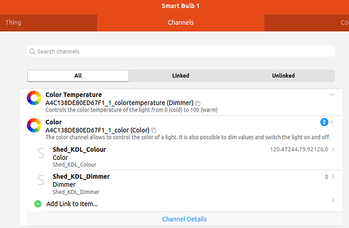

It seems that to switch this light on and off, I send HSBTyype values, instead on off.
Though the Things channels tell me it can used to switch on|off, sendCommand(OFF) does not switch off this bulb.
Also, I am sending a new PercentType(0), which switches the light off.
How does it know it should reduce brightness and not saturation?
And why does my command need a cast .toString?
Also, using the rule above and having added Shed_KDL_Colour as a switch item to the sitemap allows me to switch on the light, but it does not update the switch to OFF once the time expires.
Such a light seems complicated.
Do I need to add switch item to the colour channel to get ON|OFF functionality?
