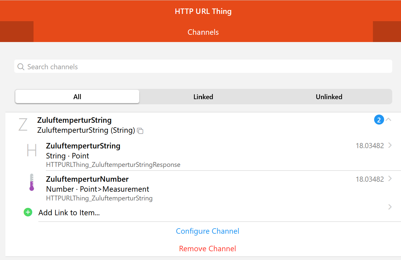

What I need to get is the value “20.77114”. Therefore I create a number item to that channel with an regex profile and expression
.*\/TL300E02B01.*?[>](\d*\.?\d*).*
which exactly maches the number “20” or “20.1” or “20.34573”. If my thinking still is right, then the state formatter should be able format and round that number via “%.1f” to “20.x”.
This does not work, Why?
At the moment only “%s” is working, “%.1f” is not.
It’s a question of which formatter.
The one in your screen shot is about formatting the output of your HTTP channel before feeding it to your REGEX profile. And that output is just a string.
You’ll be wanting to format your Item state for display, that is about the Item’s metadata state description / pattern.

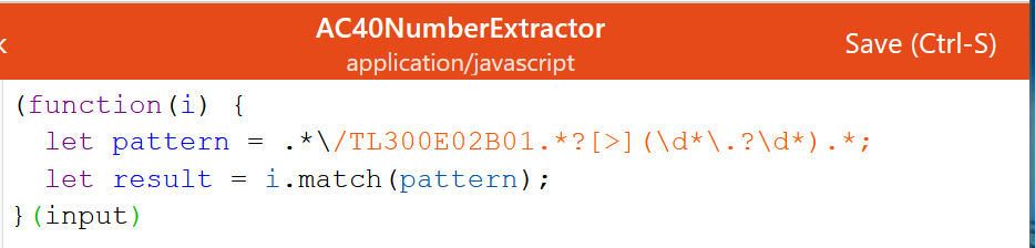

REGEX is string manipulation, it doesn’t do rounding. You’re going to need a two-stage process, first extract the numeric, then round it.

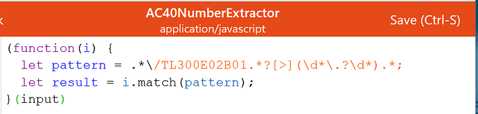

One way to combine is with a JS javascript transformation, the one script can perform regex and then rounding.
This could be applied as link profile or as channel state transformation.

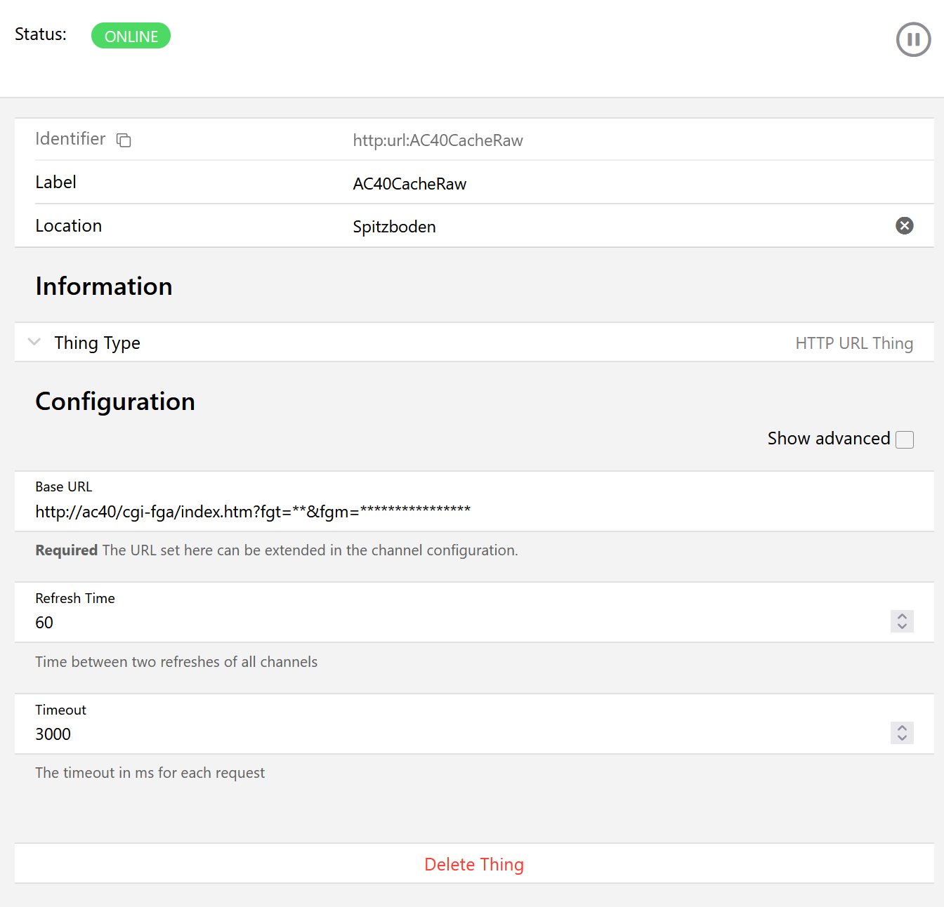

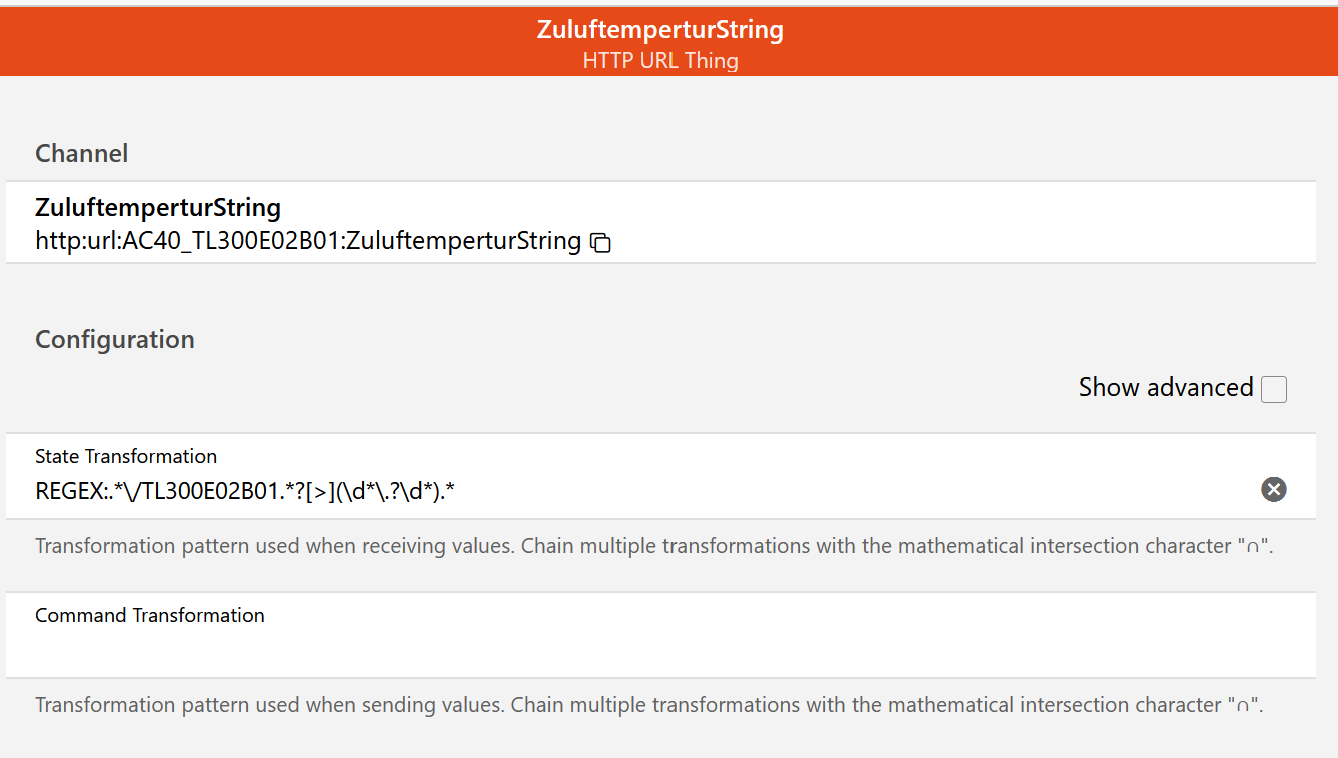

I am exactly doing this. But I am using the UI and there a “stateTransformation” is not existend within the http Binding, I only have profiles
The problem of my temperatur from my external device is that this a “resitor” values, on every reading the digits are changed. If I read every 30s I will get for example “20.12643”, “20.11836”, “20.1453”, “20.13346”
All values are rounde exactly “20.1” °C so normaly only the first one is registered as change and stored in influxdb the follwing 3 will be omited. If the next one is then “20.1.6423” → “20.2” will be stored.
This is what i try to get work. I did it now by cutting of all digits beginning with the second one.

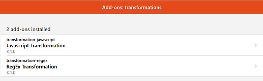

I never use .things files. I am 100% sure stateTransformation is available in the UI. The second picture in your first post even shows it’s there. You just need to enter something like REGEX:.*\/TL300E02B01.*?[>](\d*\.?\d{1}).*.
I don’t understand why you insist on using a profile. It’s all in the binding configuration. What’s wrong with using \d+\.\d{1} in the stateTransformation?

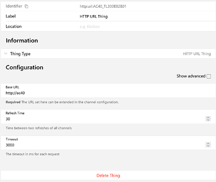

And now I have to define for every item it own channel using the state transformation. The advantage of this way is, that at the same time I also can define a command transformation and a command url. So I will be able to get/set my setpoint and also my command switches.
So I will continue this way it seems to be the better way in my opinion.

There is no situation where the profile works and the stateTransfomation does not. In fact, the stateTransformation is more flexible, since you can path the result of the REGEX to a MAP or any other transformation just by adding that (have a look, it’s all in the documentation: HTTP - Bindings | openHAB). If you want rounding: There is a ROUND profile in the basic profiles addon (available at the community marketplace),
