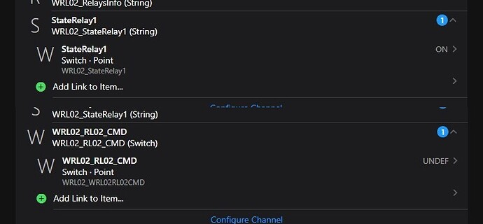

currently I’m migrating OH 2.5 to 3.0.
Most of the things work fine, but I’m in trouble with the new HTTP-Binding.
I’m trying to connect to an ETH008, which is accessed via http://xxx.xxx.xxx.xxx/io.cgi
The call returns something like relays 10000000 representing of each relay.
I’m trying to transfer the state with the following transformation:
REGEX:relays (\d)\d*∩MAP:binarySwitch.map
(The first transfarmation extracts the right number, the second maps it to on or off)
This works fine for a string, but not for a switch. Here I got UNDEF
This is my configuration:
UID: http:url:b8943d8d7e
label: WRL02
thingTypeUID: http:url
configuration:
  authMode: BASIC
  ignoreSSLErrors: false
  baseURL: http://xxx.xxx.xxx.xxx/io.cgi
  password: "ImAPassword"
  refresh: 1
  commandMethod: POST
  timeout: 3000
  bufferSize: 2048
  username: admin
location: Arbeiten
channels:
  - id: WRL02_RelaysInfo
    channelTypeUID: http:string
    label: RelaysInfo
    description: ""
    configuration:
      mode: READONLY
  - id: WRL02_StateRelay1
    label: StateRelay1
    description: ""
    configuration:
      mode: READONLY
      stateTransformation: REGEX:relays (\d)\d*∩MAP:binarySwitch.map
  - id: WRL02_RL02_CMD
    channelTypeUID: http:switch
    label: WRL02_RL02_CMD
    description: ""
    configuration:
      mode: READONLY
Hope someone could help :slight_smile:

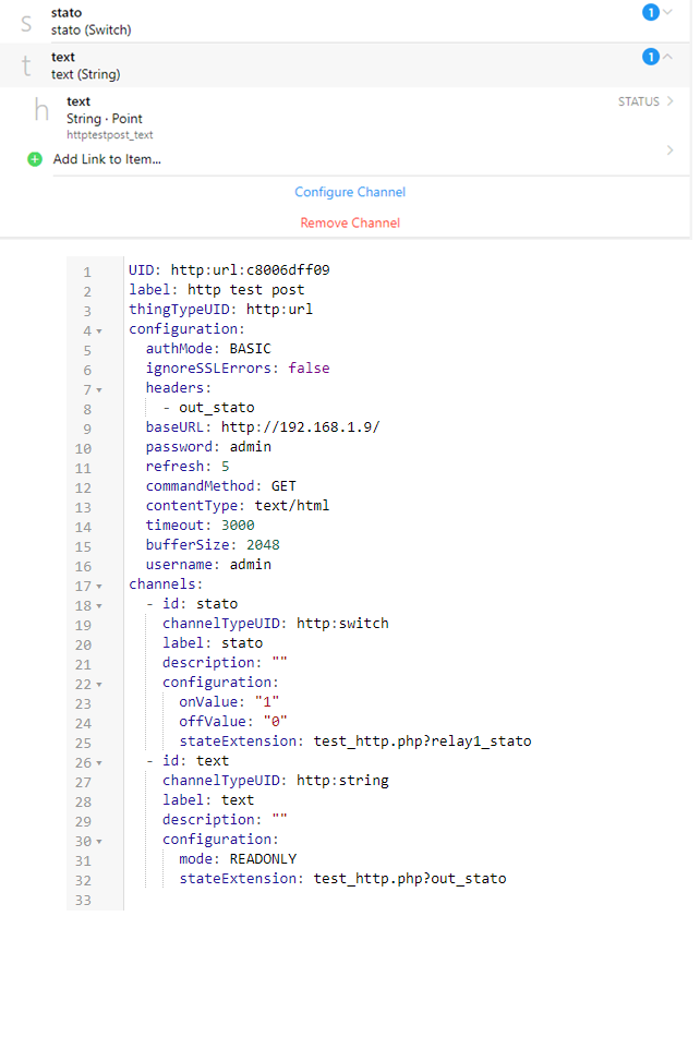

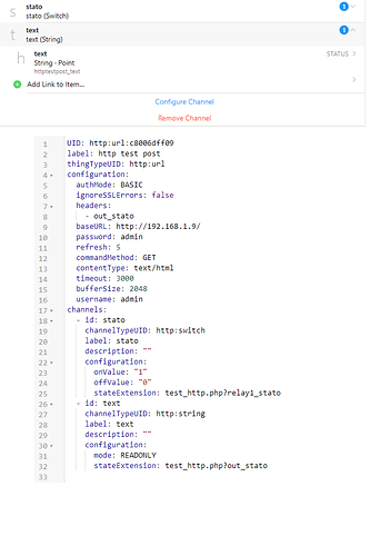

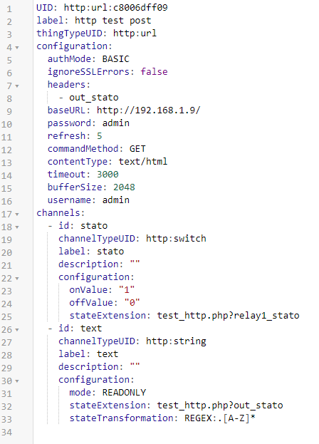

Hello everyone,
I’m a beginer in OH. I’m using OH3 and I’d like to configure a http url thing to execute command and request the state to a web server, using get and post methods. I’m able to modify the php web files to test trought openhab.
I tested the get method to read and write an output at time. After this, I tried to modify the state request to read all status bits at a time to have best performance. But, when I introduce a regular expression in “State Trasformation” field, nothing changes: there is no error, but nothing is read anymore. Maybe it doesn’t match the regex.
To simplify the testing, I created a new channel of string type and configure it to read a string by get method. This example run correctly:
But when I add a regular expression, the linked point does not update. I tested a lot of regex, but always the same result.
This is a regex of the tested ones:
Where is the issue?
I forget to say that initially I’ve installed OH2 and later updated it to OH3.
If anyone wants to try it, I can upload the test_http.php page on a pubblic url.
