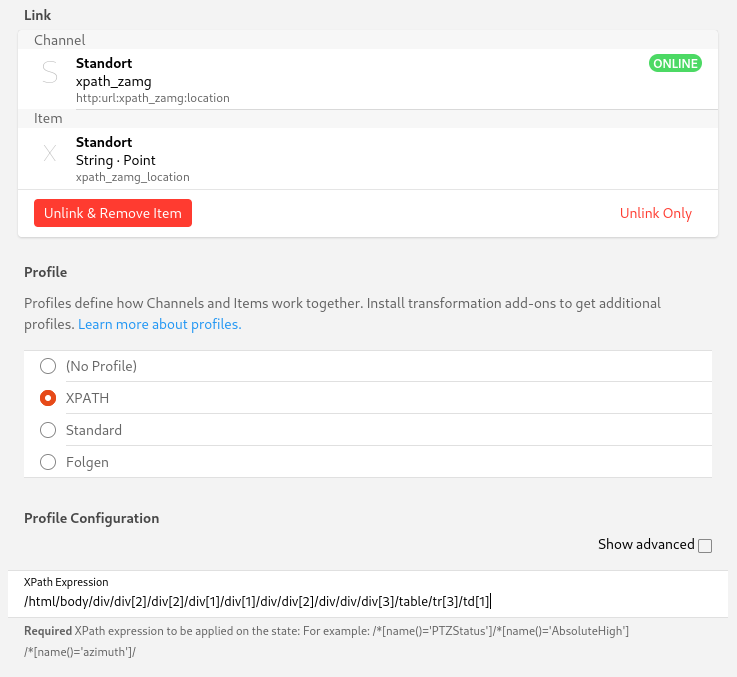

i have a problem with XPath on OH3. I would like to read a value from a website and have created the following thing/channel for it:
UID: http:url:xpath_zamg
label: xpath_zamg
thingTypeUID: http:url
configuration:
  authMode: BASIC
  ignoreSSLErrors: false
  baseURL: https://www.zamg.ac.at/cms/de/wetter/wetterwerte-analysen/tirol
  refresh: 30
  commandMethod: GET
  timeout: 3000
  bufferSize: 2048
location: system
channels:
  - id: location
    channelTypeUID: http:string
    label: Standort
    description: ""
    configuration: {}

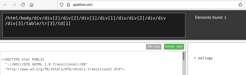

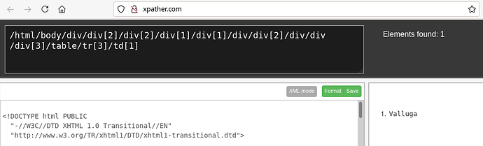

I can successfully determine the value via http://xpather.com/
My Link looks like this:
However, no value is displayed:

The XPath Transformation Service is already installed. Does anyone have any idea why this could be?

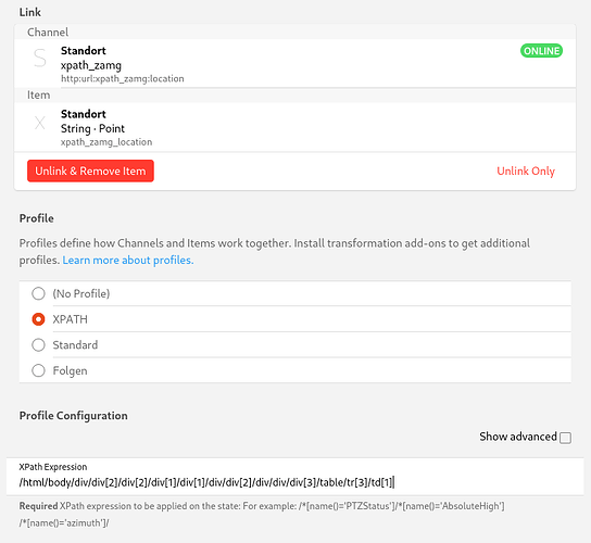

Given the data is pulled by the HTTP binding, why not apply the transform there? If there is an error it will be more apparent there as I think the Profile fails silently.
Hi @rlkoshak , thank you for your feedback.
I’ve also read that XHTML should work with XPATH. You mean the XPATH command can be executed directly via the binding? I’ve tried this now and i’m one step further. But now the whole XHTML code is downloaded and the desired value is not selected.

EDIT - the XPATH trouble is about namespace.
The returned webpage includes
<html xmlns="http://www.w3.org/1999/xhtml" lang="de">
so all the enclosed html tags are in that namespace.
I had a play in a rule; XPath with
"/html/head/title/text()"
returns nothing, because it searches for no-namespace tags.
"/*[name()='html']/*[name()='head']/*[name()='title']/text()"
returns Tirol ZAMG from the
<title>Tirol &mdash; ZAMG</title>
section, using namespace.
namespace is discussed in the transformation doc
but I find it hard to follow.
Thank you very much @rossko57 you gave me the right hint, now it works!
