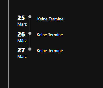

Hi @RGroll, I quite like your calendar widget, would you mind sharing it the config and css?
Currently looking into some html/css widget from searching, not yet wanted until now :slight_smile:
Cheers and happy new year!
Hey @hschulze86 and happy new year!
It’s just a timeline widget with the following YAML, nothing special tbh and just for testing purposes. Its configured to show max. 3 events for the next 2 days (+ today)
uid: Timeline
component: f7-page
  title: Vertical timeline example
  default:
    - component: f7-col
        class:
          - timeline
        default:
          - component: f7-col
              class:
                - timeline-item
                - no-margin
              default:
                - component: f7-col
                    class:
                      - timeline-item-date
                    style:
                      width: 20px
                    default:
                      - component: Label
                          text: =dayjs().format('DD')
                          style:
                            font-size: 21px
                            line-height: 21px
                            font-weight: 800
                      - component: Label
                          text: =dayjs().format('MMM')
                - component: f7-col
                    class:
                      - timeline-item-divider
                - component: f7-col
                    class:
                      - timeline-item-content
                    default:
                      - component: Label
                          visible: =items.first_event_name_today.state === 'UNDEF' && items.second_event_name_today.state === 'UNDEF' && items.third_event_name_today.state === 'UNDEF'
                          class:
                          text: Keine Termine
                      - component: f7-col
                          visible: =items.first_event_name_today.state != 'UNDEF'
                          class:
                            - timeline-item-inner
                          default:
                            - component: Label
                                class:
                                  - timeline-item-time
                                text: =dayjs(items.first_event_at_today.state).format('HH:mm')+' - '+dayjs(items.first_event_until_today.state).format('HH:mm')
                            - component: Label
                                class:
                                  - timeline-item-title
                                text: =items.first_event_name_today.state
                      - component: f7-col
                          visible: =items.second_event_name_today.state != 'UNDEF'
                          class:
                          default:
                            - component: Label
                                class:
                                text: =dayjs(items.second_event_at_today.state).format('HH:mm')+' - '+dayjs(items.second_event_until_today.state).format('HH:mm')
                            - component: Label
                                class:
                                text: =items.second_event_name_today.state
                      - component: f7-col
                          visible: =items.third_event_name_today.state != 'UNDEF'
                          class:
                          default:
                            - component: Label
                                class:
                                text: =dayjs(items.third_event_at_today.state).format('HH:mm')+' - '+dayjs(items.third_event_until_today.state).format('HH:mm')
                            - component: Label
                                class:
                                text: =items.third_event_name_today.state
          - component: f7-block
              class:
                - timeline-item
                - no-margin
              default:
                - component: f7-col
                    class:
                    style:
                      width: 20px
                    default:
                      - component: Label
                          text: =dayjs().add(1,'days').format('DD')
                          style:
                            font-size: 21px
                            line-height: 21px
                            font-weight: 800
                      - component: Label
                          text: =dayjs().add(1,'days').format('MMM')
                - component: f7-col
                    class:
                - component: f7-col
                    default:
                      - component: Label
                          visible: =items.first_event_name_tomorrow.state === 'UNDEF' && items.second_event_name_tomorrow.state === 'UNDEF' && items.third_event_name_tomorrow.state === 'UNDEF'
                          class:
                          text: Keine Termine
                      - component: f7-col
                          visible: =items.first_event_name_tomorrow.state != 'UNDEF'
                          class:
                          default:
                            - component: Label
                                class:
                                text: =dayjs(items.first_event_at_tomorrow.state).format('HH:mm')+' - '+dayjs(items.first_event_until_tomorrow.state).format('HH:mm')
                            - component: Label
                                class:
                                text: =items.first_event_name_tomorrow.state
                            - component: Label
                                class:
                                  - timeline-item-text
                                text: Description text
                      - component: f7-col
                          visible: =items.second_event_name_tomorrow.state != 'UNDEF'
                          class:
                          default:
                            - component: Label
                                class:
                                text: =dayjs(items.second_event_at_tomorrow.state).format('HH:mm')+' - '+dayjs(items.second_event_until_tomorrow.state).format('HH:mm')
                            - component: Label
                                class:
                                text: =items.second_event_name_tomorrow.state
                            - component: Label
                                class:
                      - component: f7-col
                          visible: =items.third_event_name_tomorrow.state != 'UNDEF'
                          class:
                          default:
                            - component: Label
                                class:
                                text: =dayjs(items.third_event_at_tomorrow.state).format('HH:mm')+' - '+dayjs(items.third_event_until_tomorrow.state).format('HH:mm')
                            - component: Label
                                class:
                                text: =items.third_event_name_tomorrow.state
                            - component: Label
                                class:
              class:
                - timeline-item
                - no-padding
                - no-margin
              default:
                - component: f7-col
                    class:
                    style:
                      width: 20px
                    default:
                      - component: Label

This looks very nice, but unfurtunately it is not working for me. Do I need something else?
Hello @RGroll
many thanks for that timeline widget! When I place that widget on the overview page I get this small sized widget cell, where not all days are displayed. Do you know how this can be avoid?
When I place it on a canvas layout page I get this full (auto) heigth, even how high it is. I would really have the timeline on the overview page to have it at a glance.
